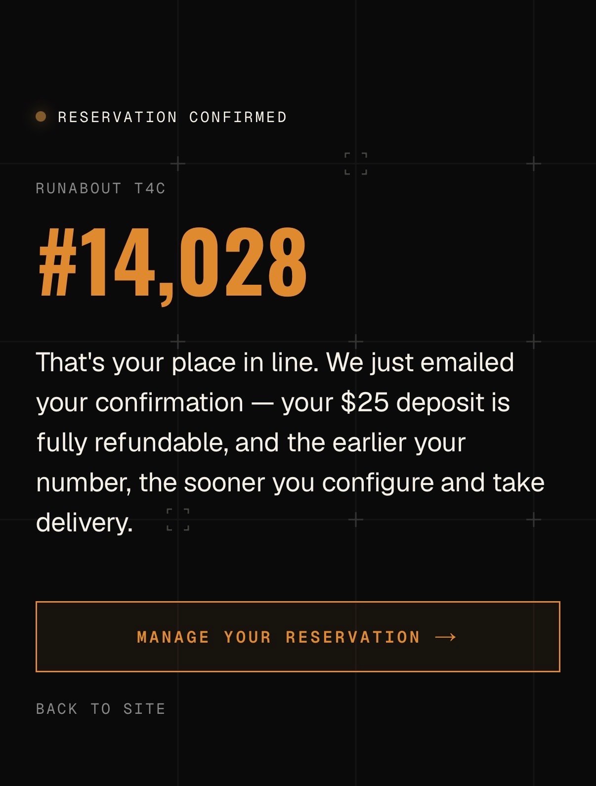

3 hours ago, Grumpy Bear said:
This is exactly what everyone here claims they want, so we’ll see if it comes to be. Skeptical but for $25 I’ll take a flyer…IMG_8966.thumb.jpeg.1352b2622d2a7c2f99be9d08d2b7b6a0.jpeg
