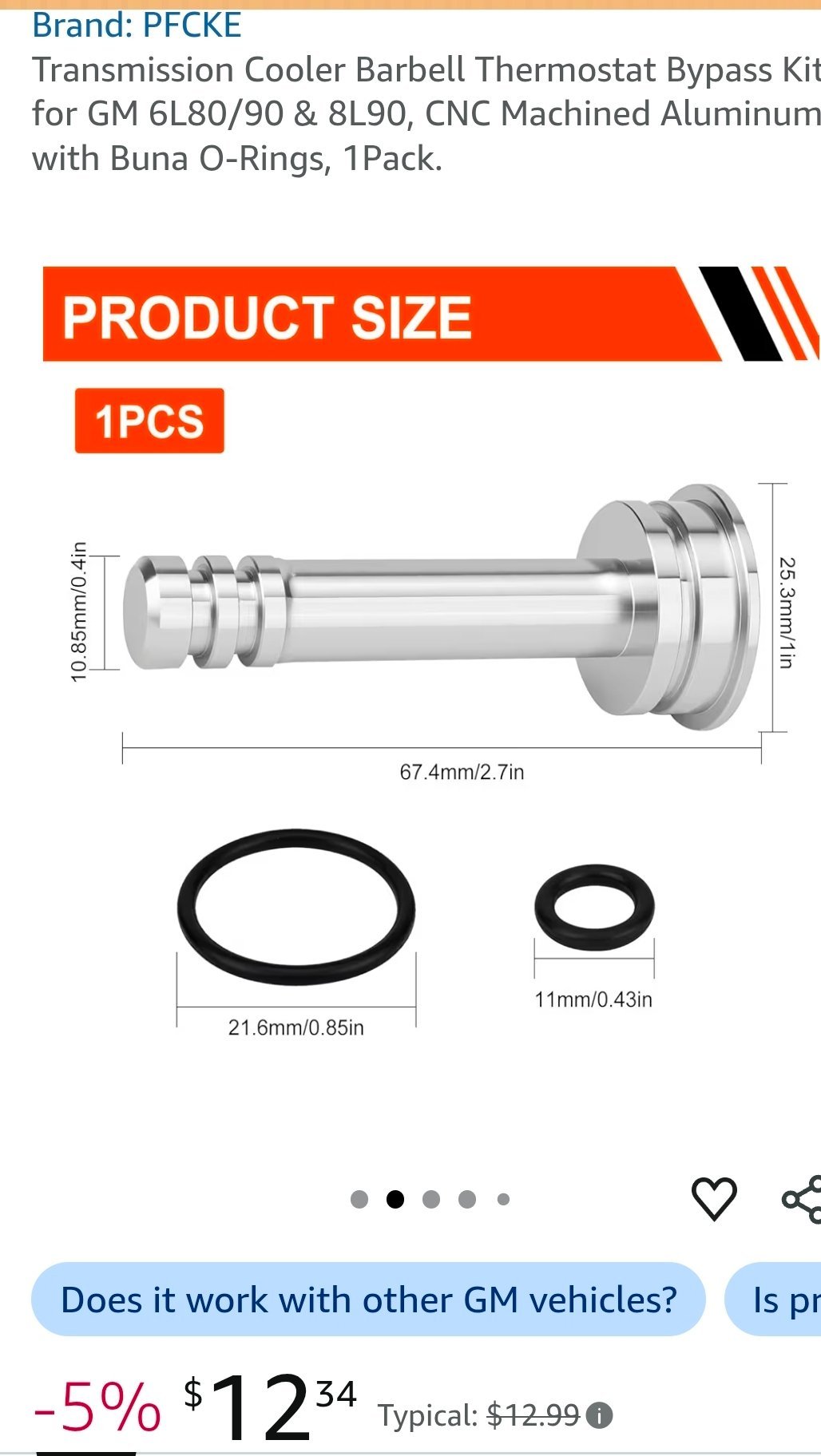

Then with the thermostat removed, I installed a thermometer defeat (bypass) that bought off Amazon. This one has no moving parts.

This seems like an even better solution than doing the pill flip. I like it!
Edited by mikeyk101
Yes, I thought so too. Cheaper & no moving parts. Actually makes it like the old 4L80E transmission. It's what I replaced my pill flip with
Miles? Has it been serviced?
I've referred to this many times over the years and I've had zero issues after the installation.
Also, it helped a friend of mine resolve transmission issues he was having with his 2018 GMC Sierra.
