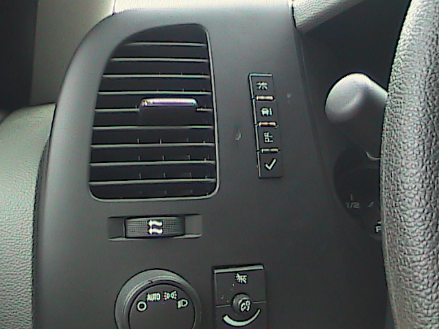

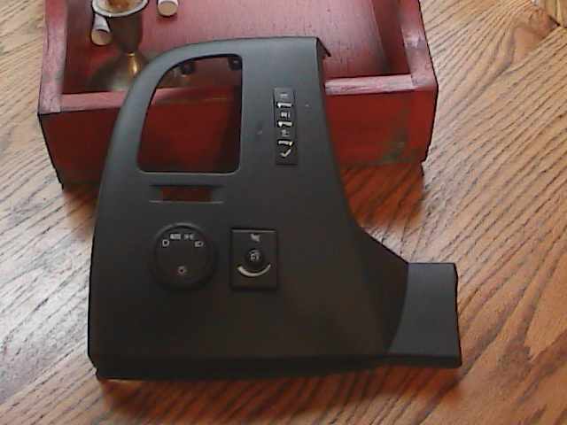

HOLY PITA!!!
You have to cut from the back to line up with clips, but cut from the front for nice finish!? Then after 1.5hr. the cutout looks decent but I got enamel off one of my tools on dash pannel, try to clean it off and it leaves a shiny spot. If I can get it clean I'll be happy with it. 2nd try would be much easier, I could make a template and do it all from the front but that kind of defeats the purpose. I say to anyone else thinking to try this "buy it and save the headache!" Most DIY'ers will have high blood pressure at best by the time they're done with this! Well that's my $.02

Looks pretty good from what I can see. I agree though, if you were saving hundreds of dollars, maybe. Saving 60 bucks, not a chance.
