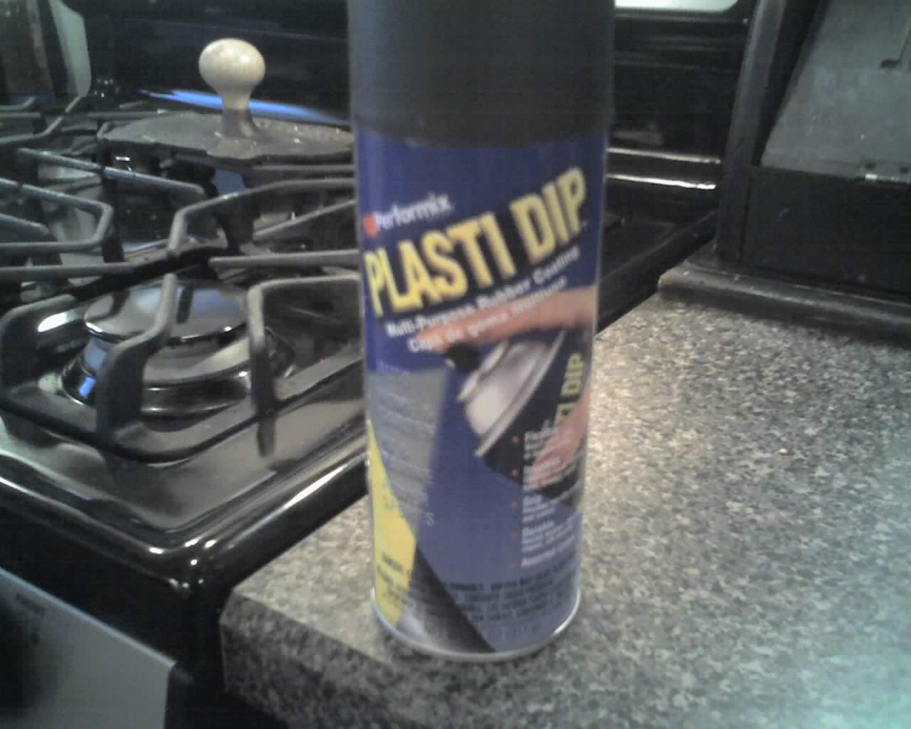

Made this lid in about 15 min, blends in to an almost stock appearance. I cut it from a 3/8"pine board, routered the top w/a 1/4"R, routered bottom so it sits down in and doesn't move. Sprayed top and bottom w/plasti dip ruber coating (holds it in place and matches well). If someone elese tries this, take measurements of all sides, it is a trapezoid not a rectangle. Let me know what you guys think of it.
