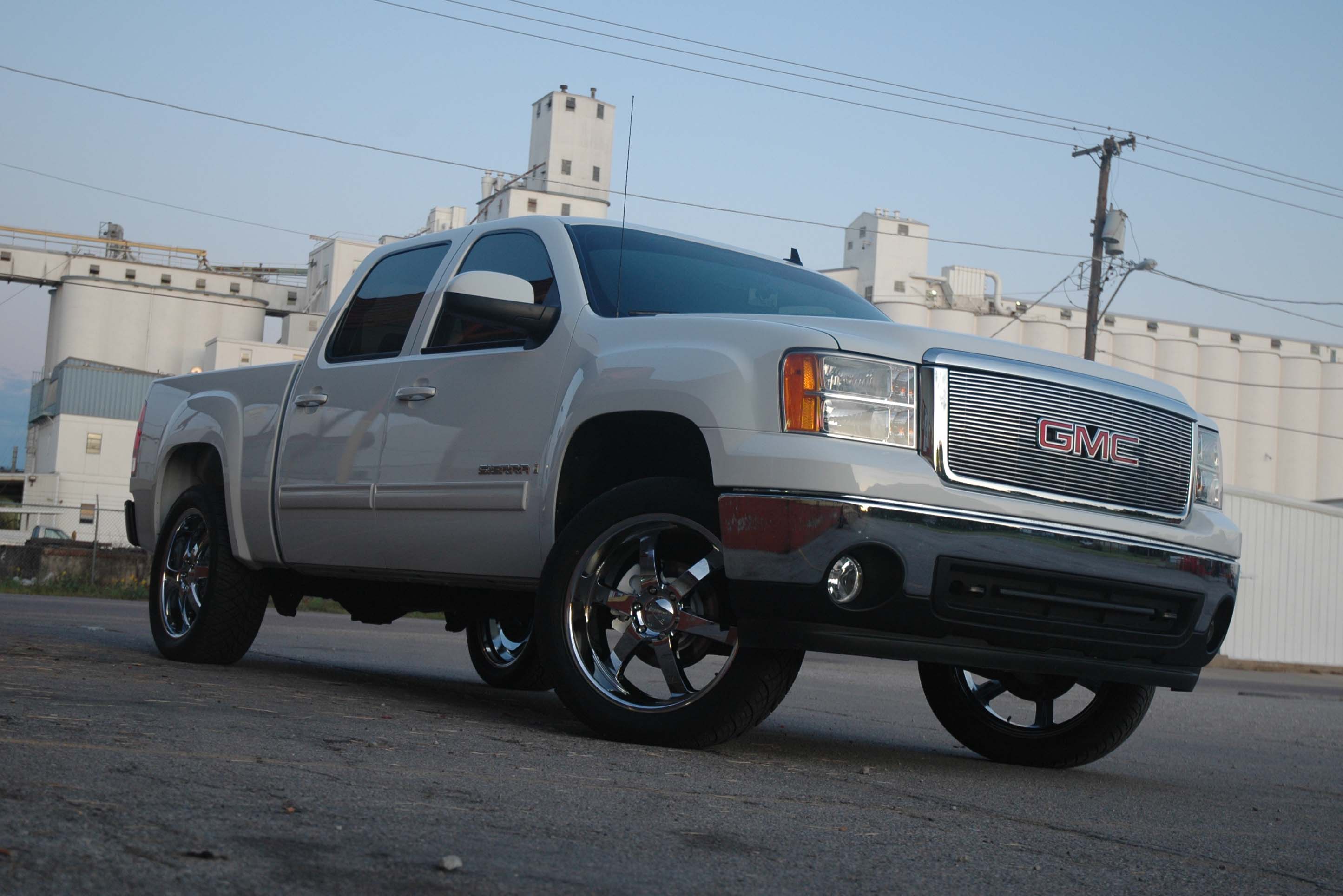

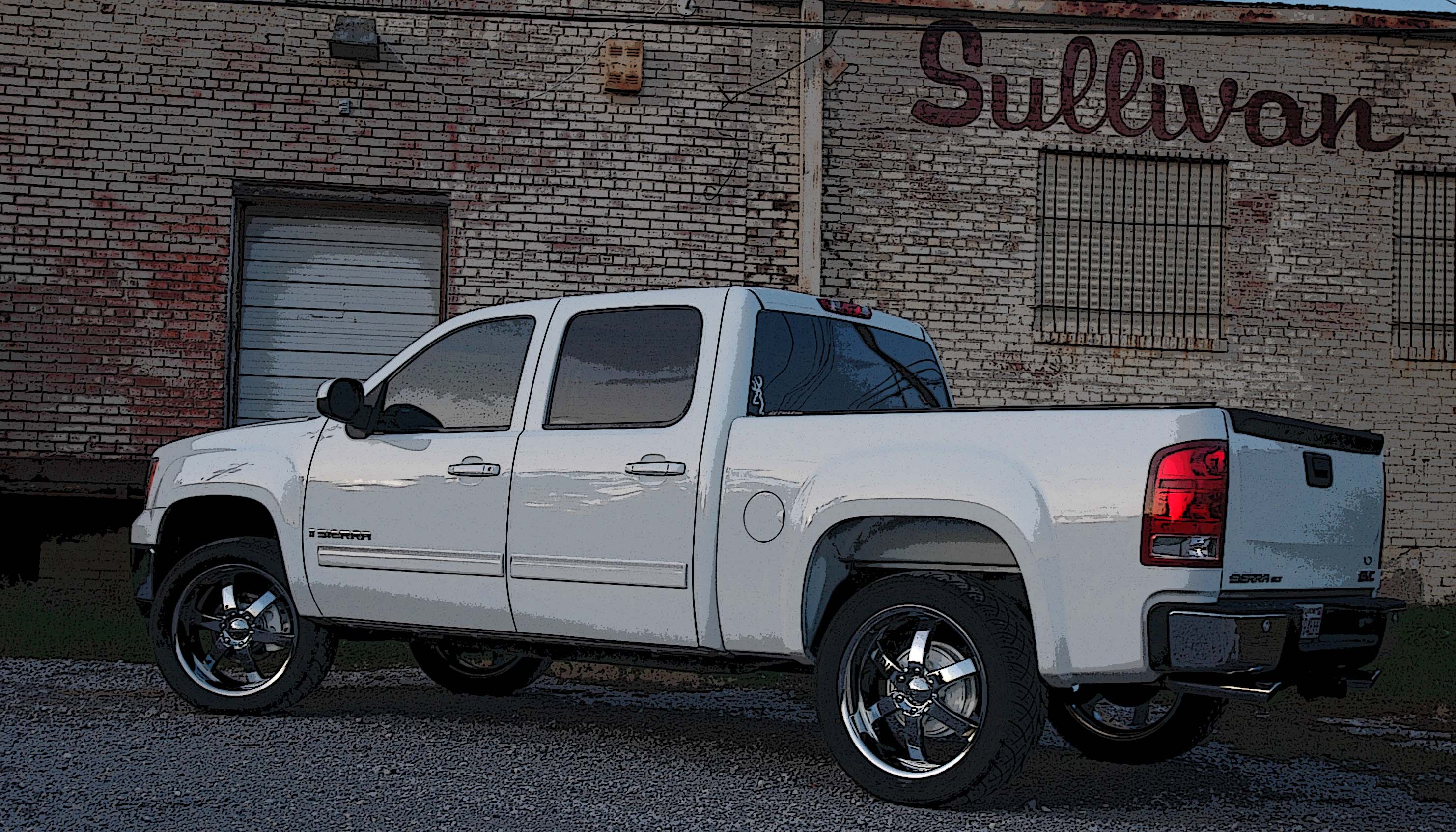

well i put a 2" leveling kit on the front so that changed the ride a little ..i could tell a diff when i put the leveling kit on, but with the 22's and the size of rubber it seems not to make a difference, other that the front being a little stiff do to the lift.
Not a fan of 22's, but if you drop it, it will look much better..............well I agree but man i grew up slamming trucks had two that got in the mini truckin mag.. just not into that anymore.. figured i would try a new look.. its ok for now.. next truck will be a 4x4 and ill start lifting :P
Looks good! I have 20's on mine and wanting the 2" level kit but not sure what to use. What kit did you get and how hard is it to install?
I got the rough country 2" coil spacers.. Taking the coils off was easy. I had to trim down my top strut studs because they were longer the 7/8.. and getting the bottom of the strut to line up with the lower a arm took a bit.. i would say a buddy and a big bar would help. Tip when you go to put the upper a-arm back in the spindle there is a internal hex that you can use to keep the ball joint from spinning when you are trying to tighten the nut.. but over all some what easy setup..
