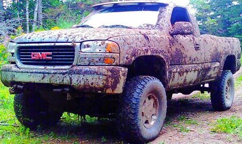

I own a 1999 GMC Sierra and i can count 6 different cracks in my frame over the last 3 years. I have off-roaded the truck pretty hard btw. But non the less this is ridiculous. I've also seen another '99 model Seirra broke right off between the cab and box. Is there lighter frames on the '99 models?

I see these trucks everyday in the dealership,I've seen literally thousands of them,I haven't seen one with a cracked frame yet.
By the picture you provided,Maybe you off-road it a little "too hard" :)

HRM, where do you live? Also, if you play hard you have to work 10x as hard to keep things working and together.... yah yah yah I saw the picture of the truck covered in mud.
