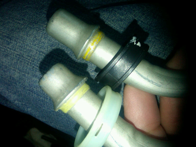

Here is a picture of the 2 possible lines my 8.1 takes. My stocker has the black clip holders
when you broke the crimp off how did you do that without breaking the line/rubber portion? cutoff wheel or something? you must have taken the lines out, and somehow pulled the house out then broke off the crimp portion right?
