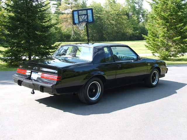

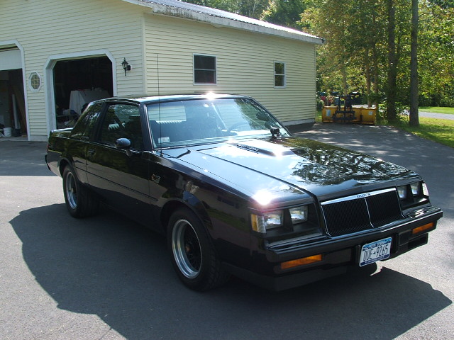

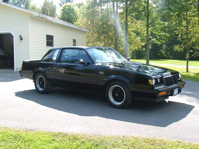

Also, do you have any more pics of that awesome Grand National?
Sweet ass ride! Did you buy new back in the 80's? Looks like you keep it garaged. From the pictures it looks to be flawless, right off the show room floor. I knew 2 people back in the day that bought them brand new. When cruising at 45 mph, he would nail the gas and the rear wheels would start spinning. Then buick also had came out with the regal T-type which was basically the grand national but a few lbs lighter I think. Someone once told me that the frames alone, sitting in a junkyard are worth a grand.
No I did not buy it new. I bought it 10 years ago, yes it stays inside with heat, yes, I do drive it. A family member bought it from the original owner for the same amount he paid new. Original paint, looks great in person as well, Thanks. The plow mount is complete, front coil springs seems to be ok, may add timbrens too many projects to stop now atleast I can plow when the need arises.
Might I suggest loosing the tennis balls and adding softballs? Any interior and engine shots? Absoultely awesome looking!
