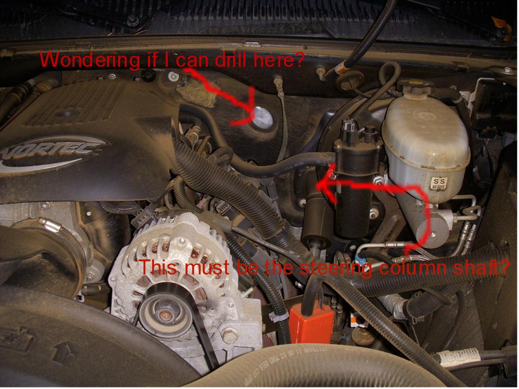

Okay I've been out looking over my truck really good today. I am wanting to add an amp and I need to run a wire to my battery from the inside of the cab. (I already have a post in the audio section on this but this is really more general info about the truck, plus I wanted to be sure nobody misses this).
Looking from under the hood of the truck there is a clear empty spot of metal. It seems everywhere else is taken. Not many clear places on the firewall I can find. As you can see in the pic this spot is just above and to the left of the steering column shaft.

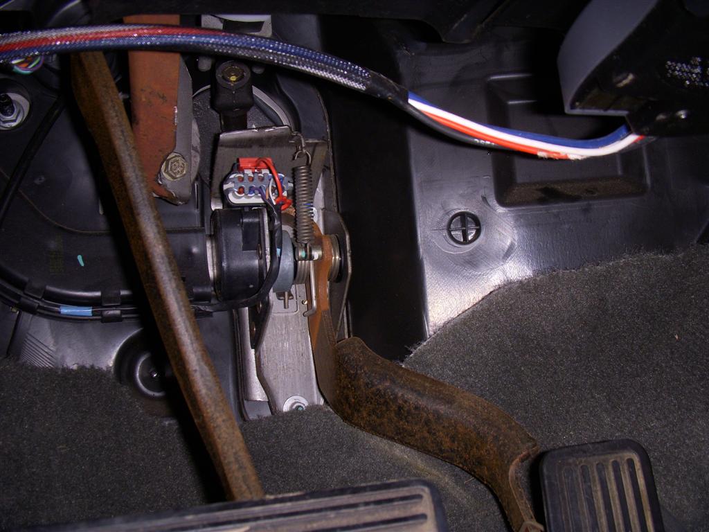

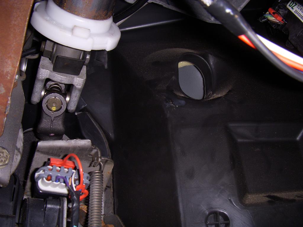

Now, looking from the inside under the dash there is also a clear smooth spot. My question is this the same spot and is it okay and clear to drill a hole through it? From the pics inside the truck it is also just above the steering shaft and to the right. But I don't know of anyway to find out if this is the same spot inside and out. I'm thinking it is, but I figure some of you diy repair guys and mechanics would already know. Also is there anyway I could test for sure before I go drilling into it? I would die if I drilled a hole from under the hood and then looked inside and the hole wasn't there or had come out in a different spot!!

Take a punch and dent it from the outside then look at it on the inside for same dent. At least that way there's no hole. Just a thought.
On my 2001 I ran my wire through the big rubber grommet that hold all those tiny wires that go to the BCM, I try to refrain from drilling new holes, if possible.
+1 On my '95, '99, and '00 silverado's I ran the wire through the large grommet of wires from the control module/under hood fuse box into the cab. Just cut a very small splice in the rubber grommet attached to the fire wall. The splice should be smaller than the gauge of your power wire, then push the wire through. It will create its own hole size and finish it off by weather tighting it with a clear sealing compound.

The way I accessed the one I used was to go from the inside, to the left of the brake pedal there is a junction box/ fuse panel. release it from it's clips and slide it to the side. You will see a large grommet with a large bundle of wires coming through it. to the side of the existing wires, poke a hole with a small pocket knife. Use a wire coat hanger and stab it through the hole and then use the coat hanger to pop a hole through the other side. once the hanger is through you can located it from under the hood. Now use electrical tape and tape your power wire to the hanger and pull it through the grommet. It may take some cussing and swearing, but it will come through. Tape it good so that it doesn't come off in the process. I've done three trucks this way.

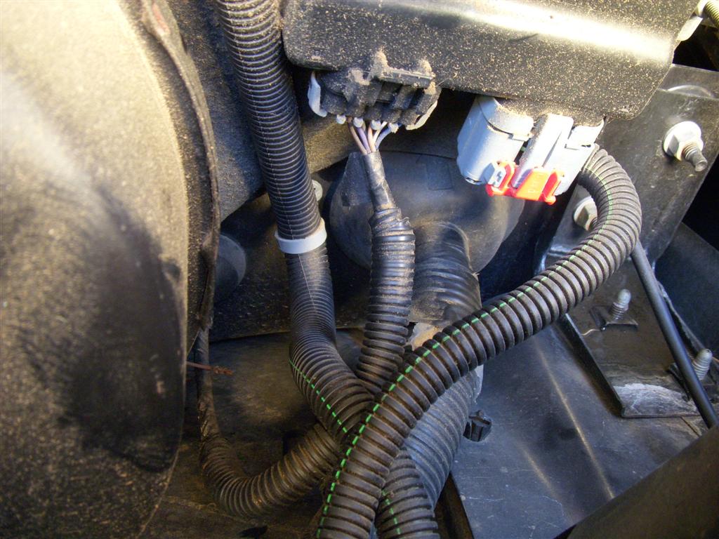

Everyone seem to be saying that it would be better to go through the exstiting grommet than to drill a new hole so that is what I am planning. I did unclip the fuse pannel on the inside and I think I found the grommet you are talking about. I took some outside pics though so I could varify. I just don't want to screw anything up.
So is this the grommet in the pic that my wire should come out of?

the grommet in your pics is the correct one. just be sure to leave plenty of clearance between your hole and the existing wires to be sure that you don't accidentally damage the truck's harness (I usually shoot for about half way between the existing wires and the edge of the grommet). You can use a flat blade screwdriver to enlarge the hole if you get in a bind, but try your best to do it without first to keep the hole as tight as possible - this varies with your wire size too of course.
Once you have the wire pulled through you can route it under the truck's carpet and no one will be the wiser.
