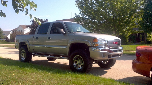

Hi guys, new to forum just yesterday i puchased a 06 gmc sierra 1500 crewcab 4x4 SLT. So far i love it, great power, great sound love all the room i have in the truck.

Welcome and nice looking truck :)
