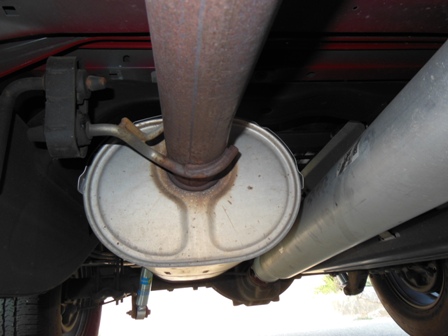

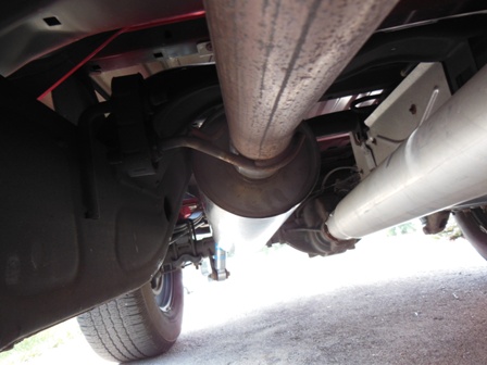

Here's pic's of the offset on my 2009
Much different than the 2010, wonder why?.........Which Bilsteins are you running?
maybe diff beteewn diffrent cab/bed combos

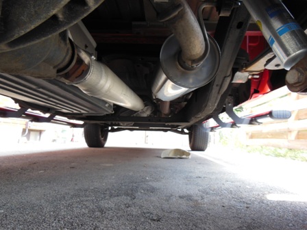

They just cut my new muffler down and cut angled connectors to slip over the the muffler ends. It runs about the same angle as my driveshaft...but higher. Never touched the stock hangers.

As stated in my earlier post, I have a completely stock exhaust except for the standalone GMPP (Borla) "Sport" muffler that I had installed today using Accuseal clamps.
