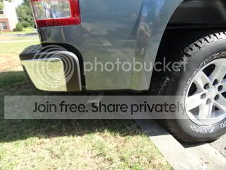

Pic of stock exhaust exit with touring muffler installed,

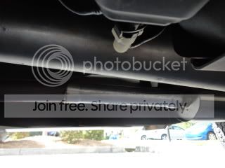

Pic of the rear of muffler through wheel well,

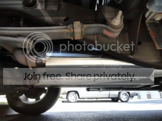

Pic of the muffler from bottom of truck, notice "GM Performance Parts" is visible.

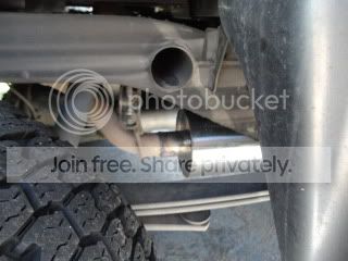

Pic of added pipe to the front of the muffler, really there is no bend, just angled. The hanger that went in front of the muffler had to be fabercated, but used the stock location and mount to the truck.

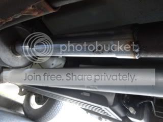

Another pic of the front from a different angle,
