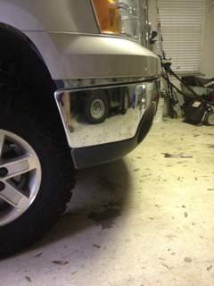

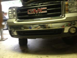

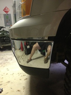

After installing a Zone 1.5 body lift I am having problems getting the gap even across the front and sides to be even. It looks fine across the front and both sides have a much bigger gap. Any suggestions? post-81420-13468844904_thumb.jpgpost-81420-134688452947_thumb.jpgpost-81420-13468845655_thumb.jpg

then it should just be a matter of loosening the 4 bumper bolts plus the brackets off on the side and shifting it up. it might take three people to make it really easy. one on each side and one tightening bolts it should have enough play to tighten up
I agree with him. I loosened all the bolts on mine and then used some jackstands to hold up the sides of the bumper to my liking and then tightened everthing up. I did this on 2 Sierra's with no issues.
