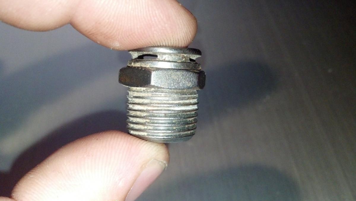

Does it thread into the cooler?
Is your problem with this quick disconnect fitting, fitting into the above fitting?
my quick connect fittings doesn't fit into the 3/8 female end

99% of threads on our trucks are metric, but I'm pretty sure those should but SAE thread. And txab was talking about the fittings on the stock cooler. I agree with him, just buy new ones, because thats how I destroyed my first stock cooler is by trying to remove those quick disconnect fittings.
And let me get this straight so I'm not giving you false info, but you said the quick disconnect fitting (male) is smaller than the 3/8" NPT on the reducer?
Yes, if I install the reducer onto the new cooler just fine, the cooler line fitting is too small to fit in the 3/8 end of reducer
That's weird. Here's what I would suggest, go to your local parts store and have them pull out a new quick disconnect fitting and take your cooler with you with the reducer and see if it threads into your reducer.

A little further looking shows their could be 3 different part #'s, One looks to have smaller threads.

Yeah, but you never removed the old cooler's fittings to see the thread did you? I know when it was tried here, the cooler metal gave way before the threads broke loose. I never saw the threads of the fitting. It's cheaper, quicker and to put all new in
I think the one I put a picture up of was from the cooler. I used PB blaster, vise grips, and put some @$$ behind it
