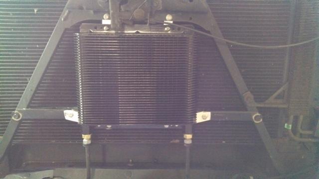

finally got it..
the two brackets on the top I found in the garage and they fit perfectly! bottom two I fabed from stick of aluminum.

Very nice and clean. Good work
thank you actually enjoy working on my truck
So do I, until you reach the point where your working on it too much... Haha
