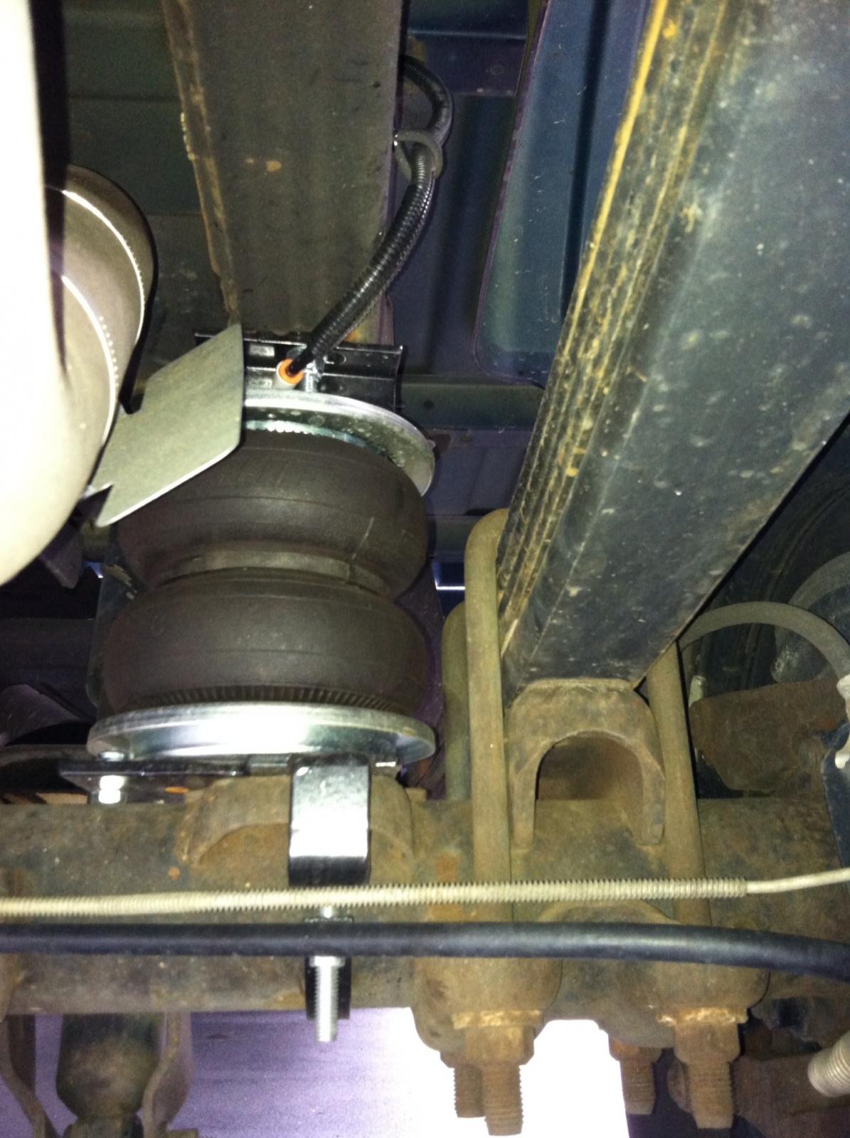

Here are some pics of the airlift 5000 bags. Pretty easy instillation
Yup I messed up first I picked the pictures but did not attach them! Doh! Overall not bad of a install. My only major lesson to others is to test fit test fit and test fit, then when it all looks to be right tighten down the bolts.

I got my airlift bags installed yesterday...a lot of work! Haha! Took about four hours, but I was being very meticulous and very careful routing the air lines.
I pumped them to 30 pounds and went for a ride unloaded. Rode pretty stiff but solid. After 30 miles, I dropped them to 10 pounds and it rode a lot better, but still a bit rough.
