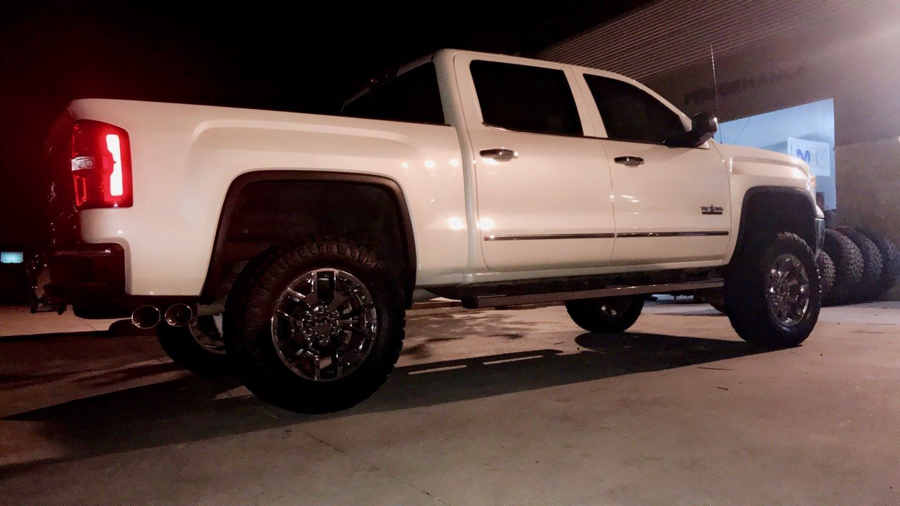

My local dealership does not void the warranty on the truck because of the lift. I asked several service guys including the service manager at two dealerships nearby. They don't warranty the parts I put on; however, they don't void all the stuff that's still from the factory. Legally, they can't void the warranty unless they can prove that the lift is the reason for the failure.
Like others have said, you can get a 360plus warranty, included for free, with the purchase of a Zone or BDS lift. It's a 5 year powertrain warranty that matches the mileage of the factory powertrain warranty. I have a 2014 so the warranty is good for 5 years or 100k mi. The warranty only covers up to $5k in powertrain in the event GM can prove the lift caused a powertrain failure and they do not honor their warranty.
I have had my truck 3 years, 42k miles and the 6" lift with 35s has been on half that time. No issues yet.
Voided my warranty. They had gm put a block on my warranty. Engine blew had to pay $5300 out of pocket for replacement. Then had to get a lawyer to fight for my money back which I got

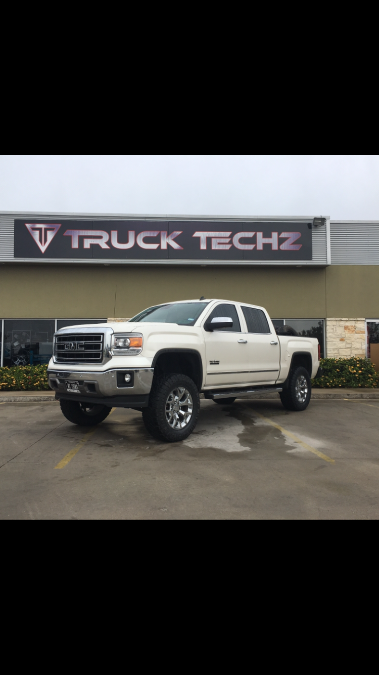

Finally got my lift installed. 6.5” zone with 35x12.50 Ridge Grapplers on stock 20’s. No spacer needed with cast steel UCA.

My GMC dealer told me I could put the lift put on and they were cool with it, but wouldn't warranty the parts, obviously.  He also said that the GM rep for my area was hard on people who installed lifts, level kits, and programmers.   He would pull the warranty if he came into the shop and an "altered" truck was being worked on under warranty.  It didn't matter what the problem being worked on was.  Kinda, put the kibosh on my plans.
