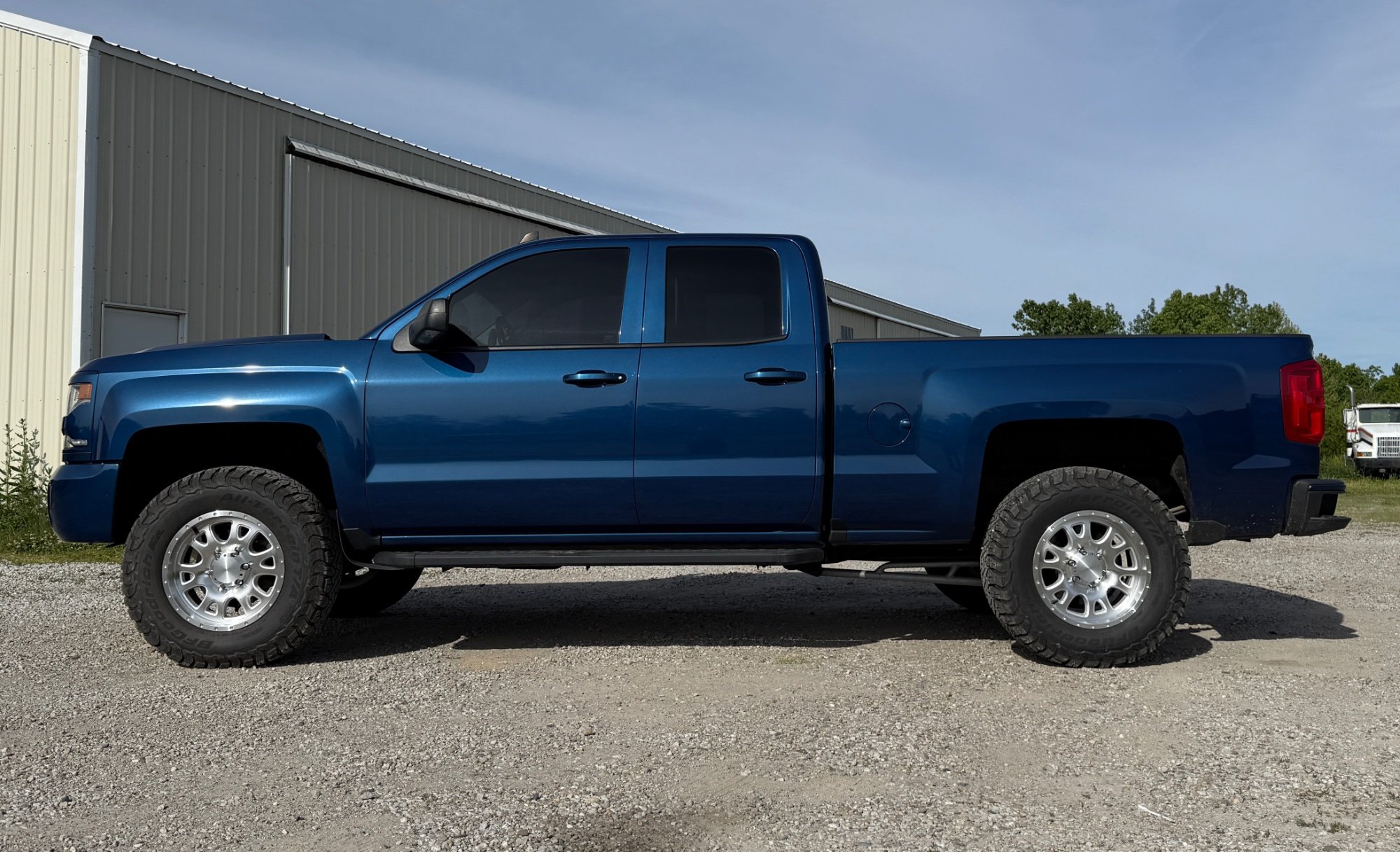

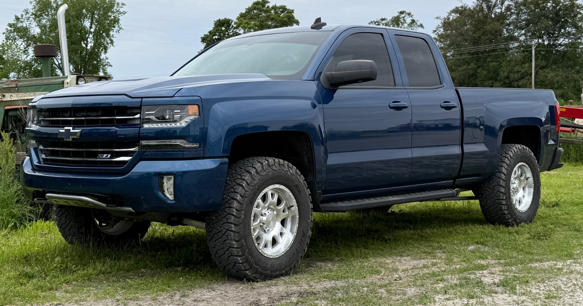

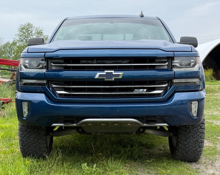

IMG_4315.thumb.jpeg.f192b26577bdc2e2d9458e2592f22397.jpegIMG_4316.thumb.jpeg.8d2392e9727e2875c8ab093ce431bf49.jpeg
2016 Z71
Eibach Pro Truck Stage 1 kit set at 2-1/2” of front lift.
2” rear lift blocks replaced the factory 1-3/16” blocks.
305/65/18 (34x12) BFG KO3 on 18x9 +12mm offset Black Rhino wheels.
Front tires are 1/2” outside the fenders and the back tires are flush.
Front tires slightly rubbed the back corners of the fenders and fender liners. I trimmed the fenders and made trim plates. I used a few strategically placed zip ties to pull the liners back.
Edited by HoosierZ

Bought a set of Superlift upper control arms to fix my ball joint angle and I may add a thin spacer under the lower strut mount to add another 1/2” of lift for a total of 3” lift.
Nice looking truck!
I've had the Eibach Pros in my garage for about a year now... just haven't had time to install them yet. How do you like them? How bad was the ball joint angle after the install? I was under the impression the angles would be acceptable as long as the lift wasn't above 2.5". In the end, I will be changing my UCAs; the biggest issue is finding ones that will work with the factory 20x9 rims. I really don't want to buy ones..lol.
  • 4 weeks later...
On 12/10/2025 at 7:59 AM, UrbanRage said:
Nice looking truck!
The Eibachs with their springs definitely stiffened up the front suspension. They can be a little bit harsh at times such as the edges of bridges where there is a ledge. I feel cracks in the road a little more but they soak up larger bumps much better. They did tighten up the handling in curves with less body roll. The front end doesn’t float and bounce like it did with the factory Ranchos. I am running load range E winter tires and the BFGs are LR F.
The ball joint angle wasn’t bad but the arms were nearly on the droop stops at ride height and I wanted new arms to allow me to lift the front another 1/2”. Eibach recommends not using their shocks with the stamped steel arms due to the possibility of upper ball joint separation. Mine had the aluminum control arms which appear to be the best of the 3 different styles. They have a larger ball joint than the cast steel arms and they don’t pull out of the arms like the stamped arms. These Superlift arms appear to have the same wheel and tire clearance as the factory aluminum arms but they are much thicker and they have clearance at the droop stops to allow more travel without having to cut out the stops that some aftermarket arms require.
The ball joints are replaceable and happen to be the same one as an early 2000s GM HD truck according to Superlift.
 This week, I pulled out the shocks to replace the UCAs and while I had them out, I disassembled them and cut another circlip groove 1/2” below the bottom groove with my lathe to reduce the compression on the springs and lower the lift height around 3/4” to increase the droop travel and hopefully soften the ride a little. I added a 3/4” thick lower strut spacer which combined with the lower spring lift gave me an additional 1/2” over where it was at. It now sits at 3” of total lift. I also made and installed a 1” diff drop to save the CV joints. The ride seems to be a little better but it could just be my imagination.
