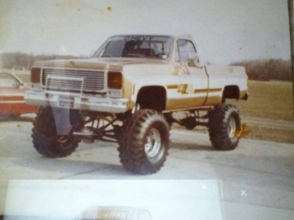

Why would I want to go bigger? this is my old C-10:
