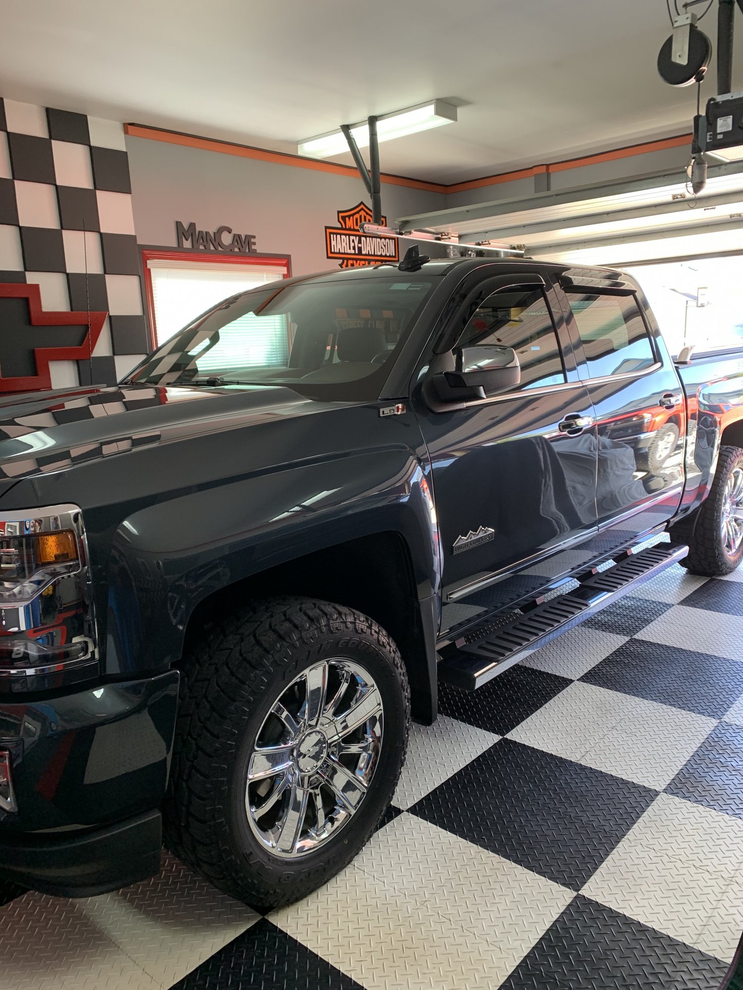

I finally did a RC level lift on my HC yesterday and had Toyo At Extreme 285-55-20 's put on. Rides great and no rubs. It took the HC from an old timers truck to a total aggressive stance. Took me a while to nerve up to do it. I don't know what the hell I was worried about. I love it.

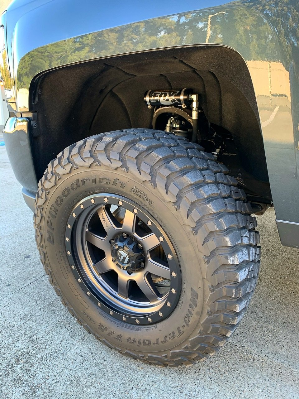

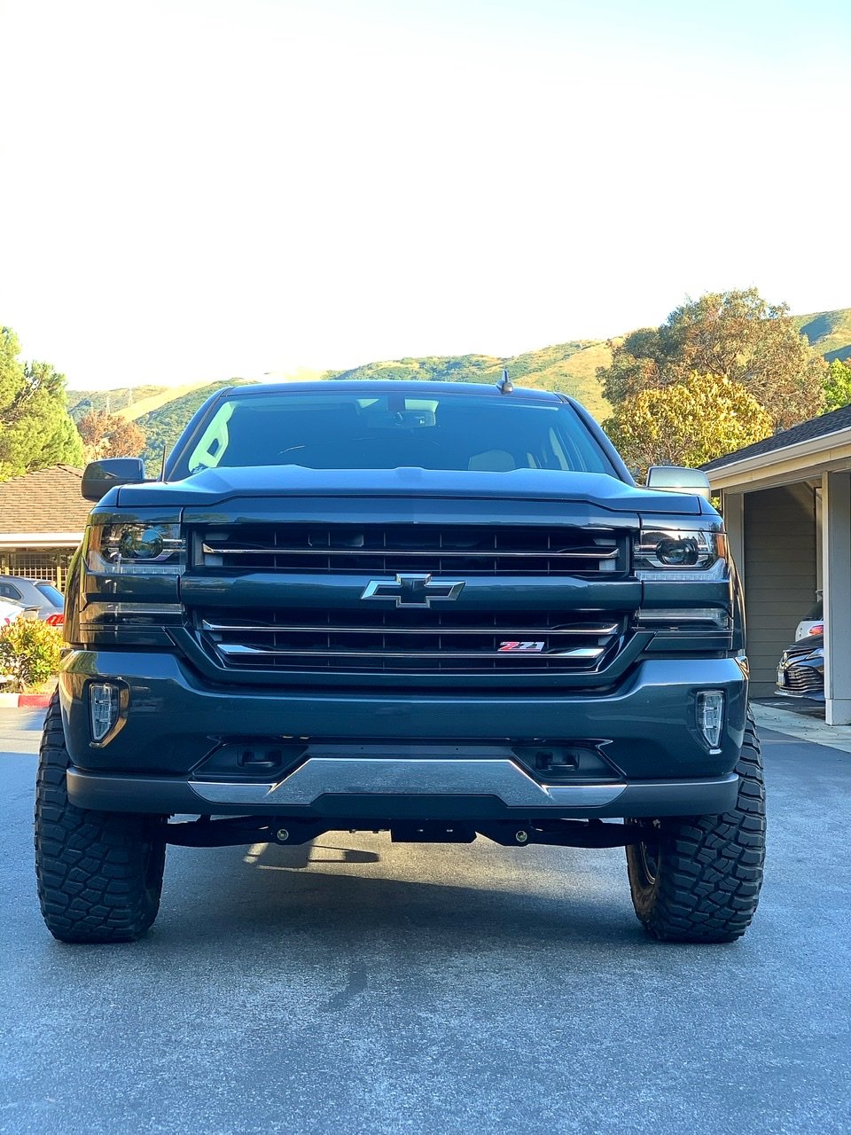

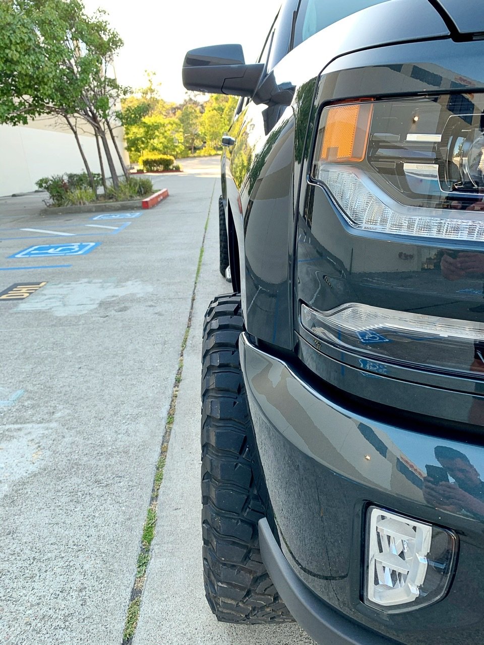

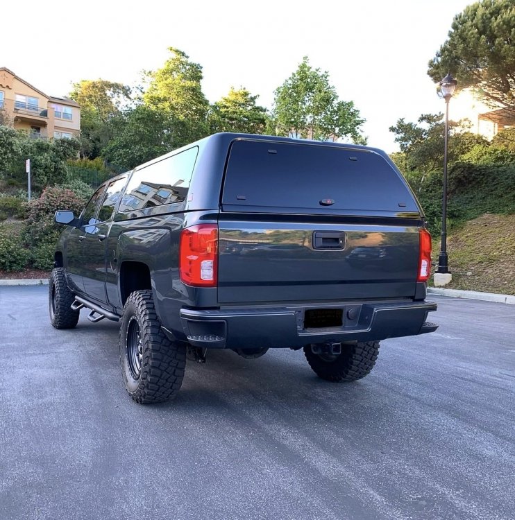

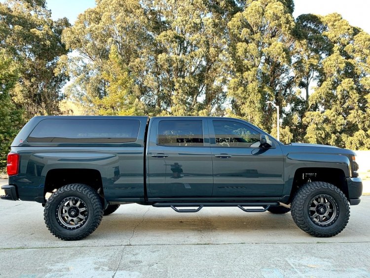

Changed up my 2” moto fab front level to this..
4” BDS with Fox 2.5 coilovers. 4” block in rear with Fox Performance Series shocks. Fuel Trophy 18x9 5”bs, +1 offset. BFG Km3 295/70/18. Only have about 200 miles on the setup, but rides great so far. Minimal plastic trimming to front bumper valance and mud/rock guards. Tires still rub just a bit on felt liner when full turn in reverse. 0C5C7CD4-7AA8-4726-9CA7-ADB342BA54F2.thumb.jpeg.fb2255f64b473061535eb2c192cf3f0f.jpeg

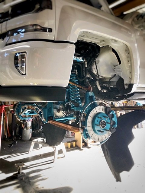

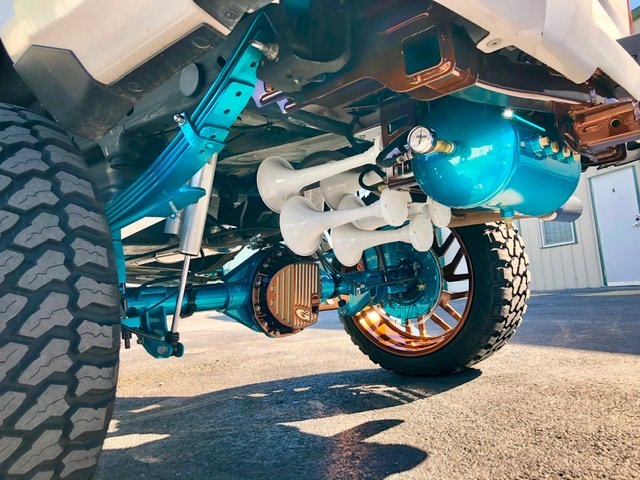

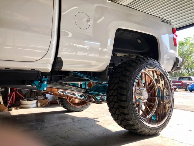

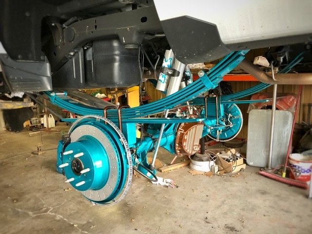

Version 2.0 “The Rebuild”
McGaughys 9 inch SS kit pushed an inch
McGaughys UCA
Movtech LCA
7-10 Fox DSC coil overs
McGaughys Traction bars with my custom made face plates
6 inch Deaver leaf packs
Fox Resi’s in the rear
Zone 1.5 body lift
TIS Forged 26x14’s
Fury Offroad 37x14.5R26
219A3403-FEDC-4732-B282-C2D26EB71E6B.jpeg.3201e04911a3b7ef68ed09601b08475d.jpeg308E7469-E48B-416F-8B98-4C520861D392.jpeg.a2b371ec7df670d2e7e548518ec60b8a.jpeg117F9F7F-6FFA-48DB-8261-E6A15D2CFFD0.jpeg.8dbc63f5d4002b53e77c0eee66f68305.jpeg73280C02-BC68-43DE-91A5-A4209E4F0039.jpeg.101ee867a48ac6ef8824073d491cd0ba.jpegCF29C2DE-2CF7-466D-A73C-7BA700DFE50E.jpeg.300b33962307a723d0b754acf84af4eb.jpeg5F73F854-2F28-4120-8131-FEB411E7A7F3.jpeg.61809e75ca1ce9722516ca9084be6b11.jpeg30A212DB-3626-4B43-BC11-4C7A845167AA.jpeg.9ff668d4997db5af17c7957eb8425c75.jpeg

My god that is pretty.  I now wish i had my bds suspension powder coated to a different color :(
