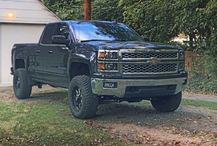

I did the CST 4 1/2" lift on mine, I went with there coilovers. You can use your stock struts with the the spacer provided with the kit. The CST is a bracket lift, which keeps your track width stock. Kit comes with everything needed other then rear shocks. I purchased the CST street series rear shocks and am happy with those. I think they were $200.00 for the pair. I also removed my overload spring and installed a Deaver J1 mini-pack with the factory block. Kit comes with 3" which I didn't use. That gave a very nice ride in the rear. Truck actually rides nicer now then it did stock.
The lift is designed to run a 35" tire with a 5" backspace wheel. I'm running a 33x12.50/22 on a 22x10 -25 wheel with plenty of clearance.
Looks great, but ooof, that kit is $2,000 (not including coilovers).
I bought mine from Performance lifts, I see they want $1850.00 for it now. I don't think I payed quite that for it. I know some have purchased it from New Level for less. It's a high quality kit that keeps factory geometry, not an over stretched level like the RC 3.5".
That kit does nothing to correct for the tie rods or lower ball joint angles and gives you a small diff drop that still puts the CVs on a pretty extreme angle.
