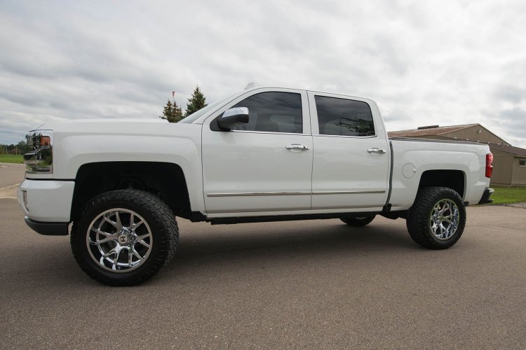

Here’s my truck on a 6” Fabtech lift running 35s. Rides good and I’m happy with it. It does some off roading so not a street queen
