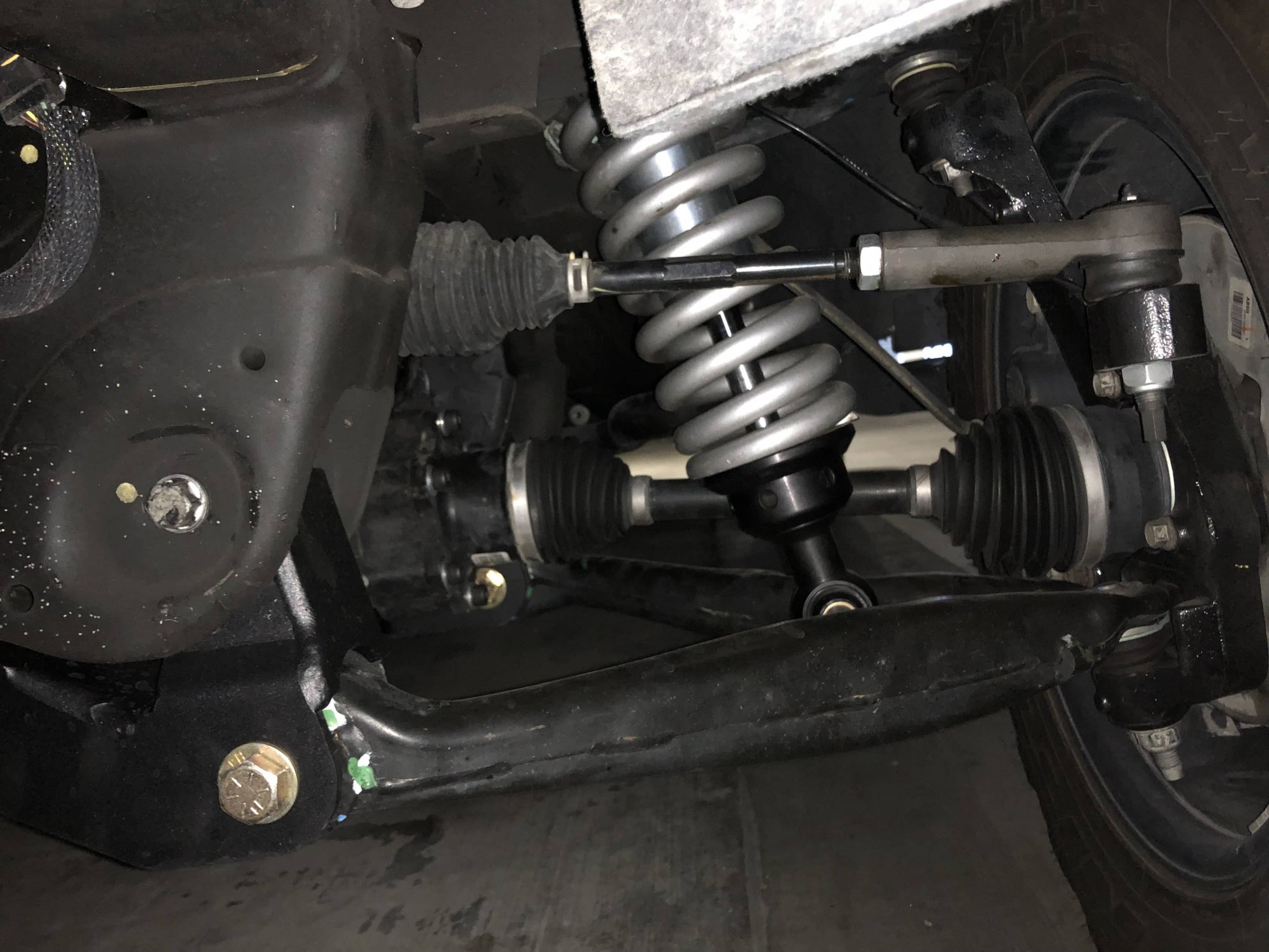

So I just want a 2.5" lift/level  for my truck. I was considering the rough country 2.5" leveling (2.5" front, 1" rear). What would be the cheapest suspension lift to achieve a 2.5" lift/level  that I can compare it to?

There aren't many lifts (that aren't actually just levels) at that height. You probably won't find anything comparable in cost either.
Next step, at that height you want, would probably be to compare the leveling blocks to a set of decent coil overs and replace rear shocks. The only real difference between either of those level type kits and a "lift" is going to be geometry correction for uca, CV, and mayhaps a diff drop. That said, 2.5" in most cases doesn't require those so it's rarely done.

I would for a good set of coilovers and get the 2.5 out of it. Don’t really even need blocks. Back of truck will be about a inch or so lower.

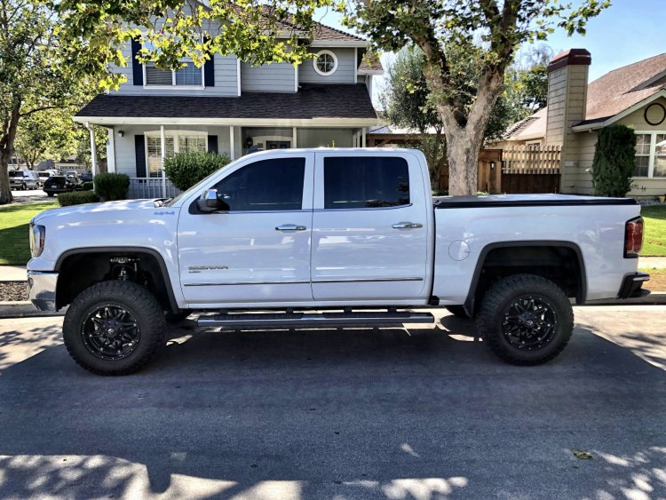

My 2018 Sierra 1500 SLT with BDS 4 inch lift and Fox coilover’s 2.5 DSC. BDS rear leaf springs in the back. Rides like a dream. Angles are good. Wheels are 18x9 and tires 275/70/18 (33’s).
