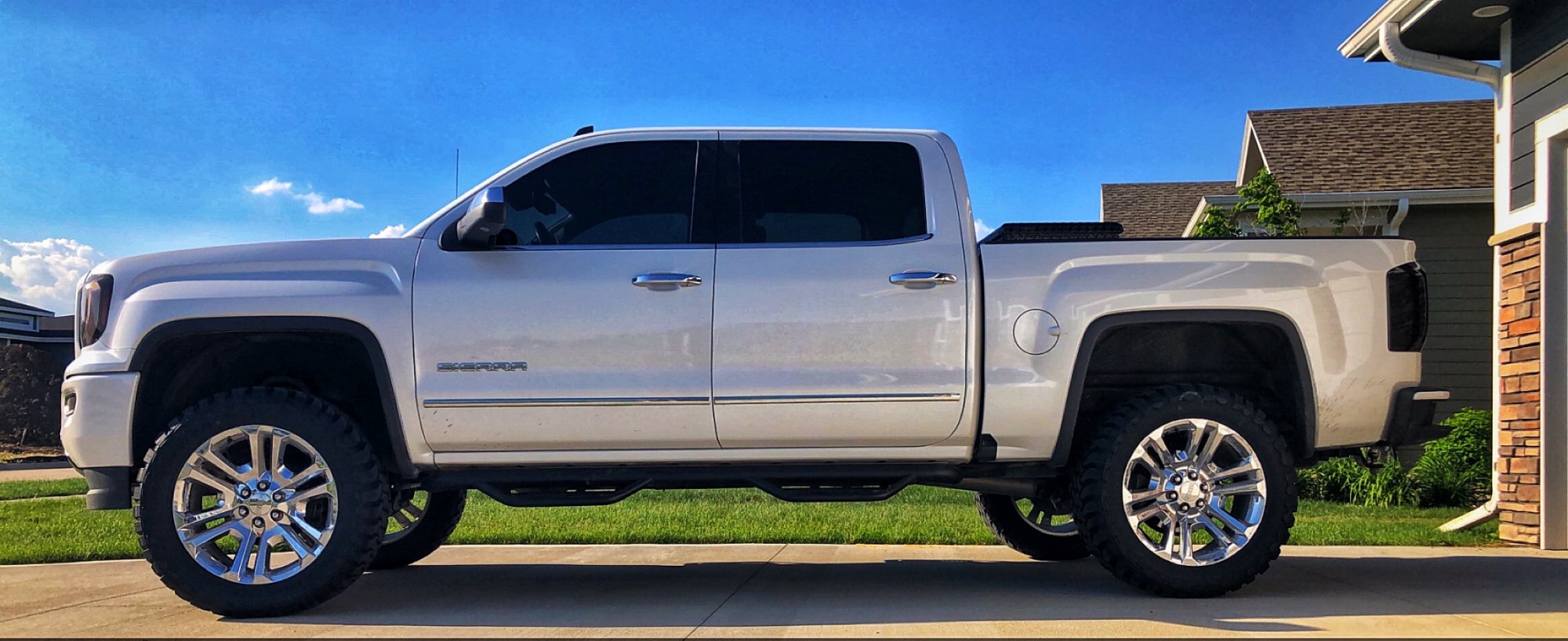

CST 3.5" Spindles / Deaver U182 with shackle/hanger setup and 1" block. 0 preload set in the Coilovers
How do you like the Deavers? Do you tow anything?
I love the Deavers but they are designed for ride performance. I removed the hitch so don't tow anything, but yesterday I had about about 650LBS in the bed with minimal squat in the rear. Adding weight definitely softens up the pack a lot so I did adjust the shocks firmer to compensate for that

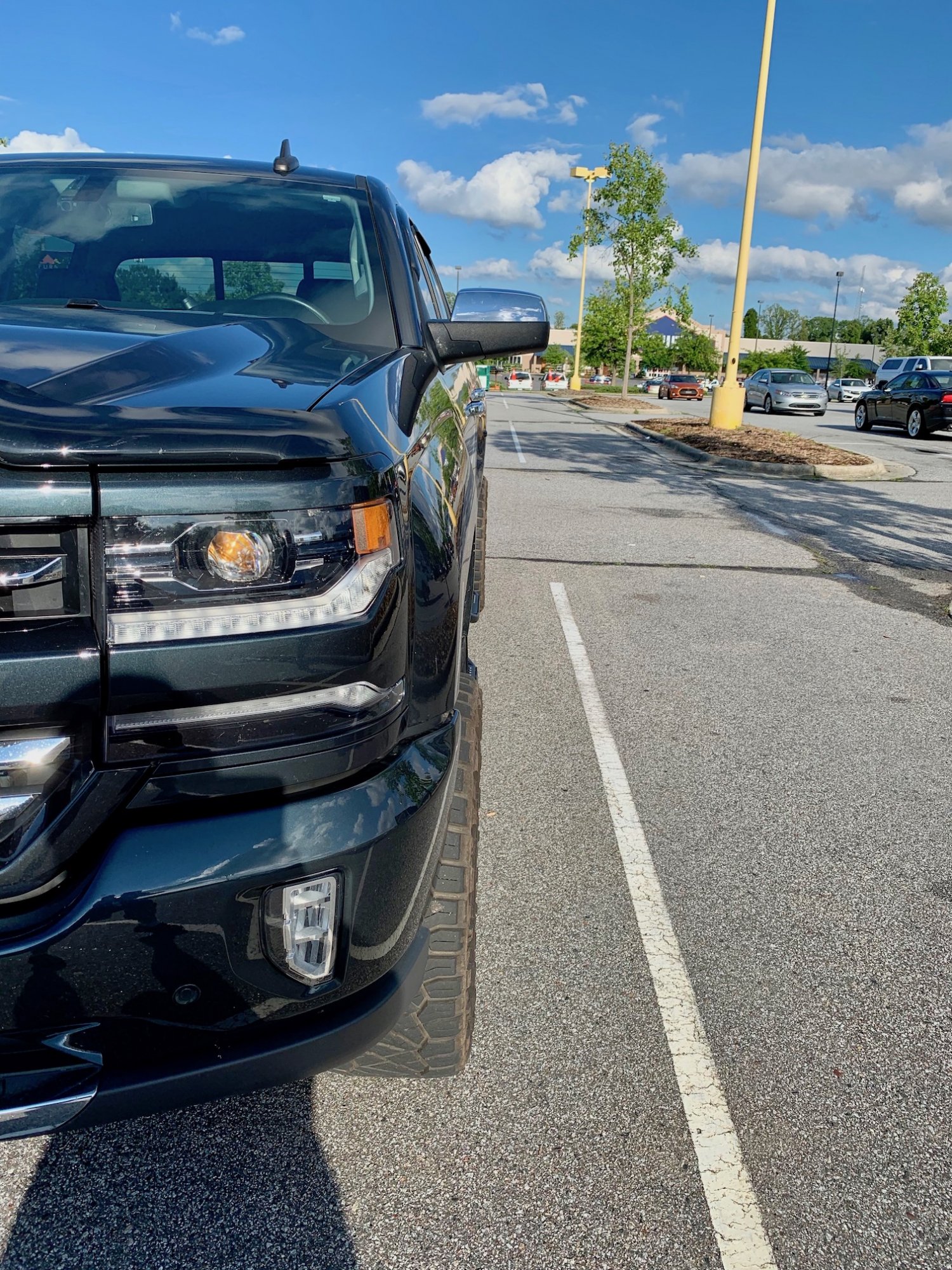

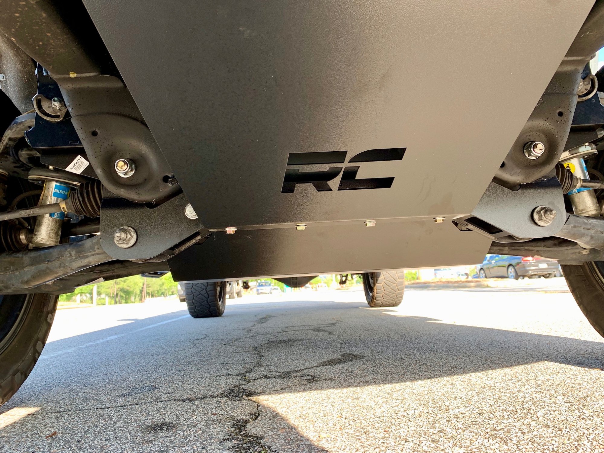

I just got da beast back from the shop yesterday from having the RC 5" bracket suspension kit put on. I kept my adjustable Bilstein's up front, but put them back to stock height and put some Fox Performance Series 2.0 IFP shocks in the rear. I would have liked to put in the reservoir shocks in the back, but too rich for my blood right now. The front wheel well measures at 42" and the rear at 42.5", which was only 4" in front and 2" in the rear difference in lift over the bilstean's at the top setting and 3" blocks in the rear.
I also installed a set of N-Fab LG Podium steps. Excuse the dirt, but it had been pouring down rain and had to help a friend remove a tree from on top of his shed.
