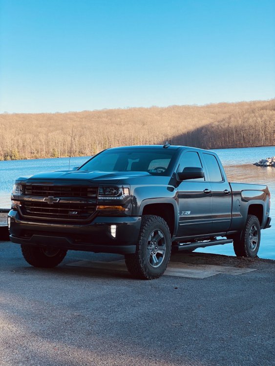

looking to raise the truck a little more then it currently sits and hoping someone can give some ideas on what to get.
2016 double cab with bilstein 5100 all around set to the highest on the front. with nitto ridge grapplers 295/55/20 and 20x10 -19 wheels I had to take off the gator back mud flaps up front as it rubbed awful so I did that , did a quick half assed "norcal" and I only rub in reverse full lock on a bump. so everythings pretty much good as it sits however im getting annoyed with the amount of crap flung all over the truck so I ordered some fender flares off amazon, and id like to get the mudlfaps back on to prevent snow build up on my running boards. looking at the duraflap ones as that lifted kit bracket they have looks pretty good for rubbing issues.
not sure how much higher I need to go on the truck if at all to help alleviate rubbing issues with mud flaps installed but I would also if possible keep my existing bilstein shocks
would a 2.5"-3" spacer level kit work with some new upper control arms to help with the angles be pretty much all I need ? I don't take the truck off-roading and I don't need the best of the best just the most cost effective way to do this properly
thanks!
