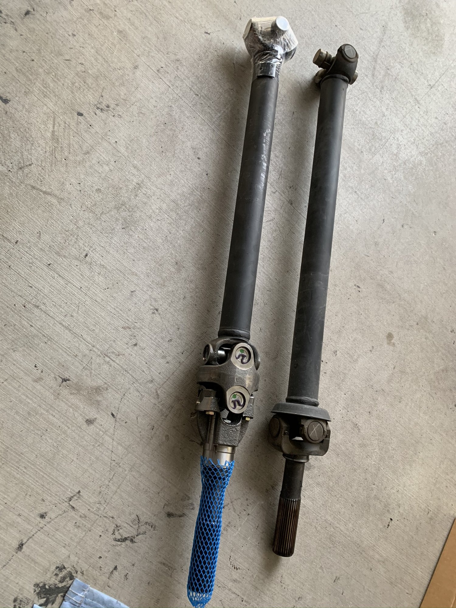

Anyone have any insight into the vibration I am getting in 4 Auto and 4 Hi after installing a BDS 4" lift?  The transfer case was smooth as butter prior to the lift.  The vibration is almost like a groan that can be felt in the transfer case upon acceleration between 10-30 mph.  The shop is stating that I will need a CV (dual cardan) front driveshaft as the pinion angle and prop shaft angle has changed and the u/joint angles are no longer in phase.
Yet, it seems there are plenty of others running 4" and 6" lifts that don't require a CV front driveshaft and have no vibrations in 4 Auto and 4 Hi.  And then there are the others that are stock and have the same vibrations.  ?‍♂️
My original suspension lift was 7” FTS kit.  I did have a little vibration with the stock front drive shaft.   I went taller with a Cognito 12” lift and opted for the double cardan drive shaft and problem solved.
