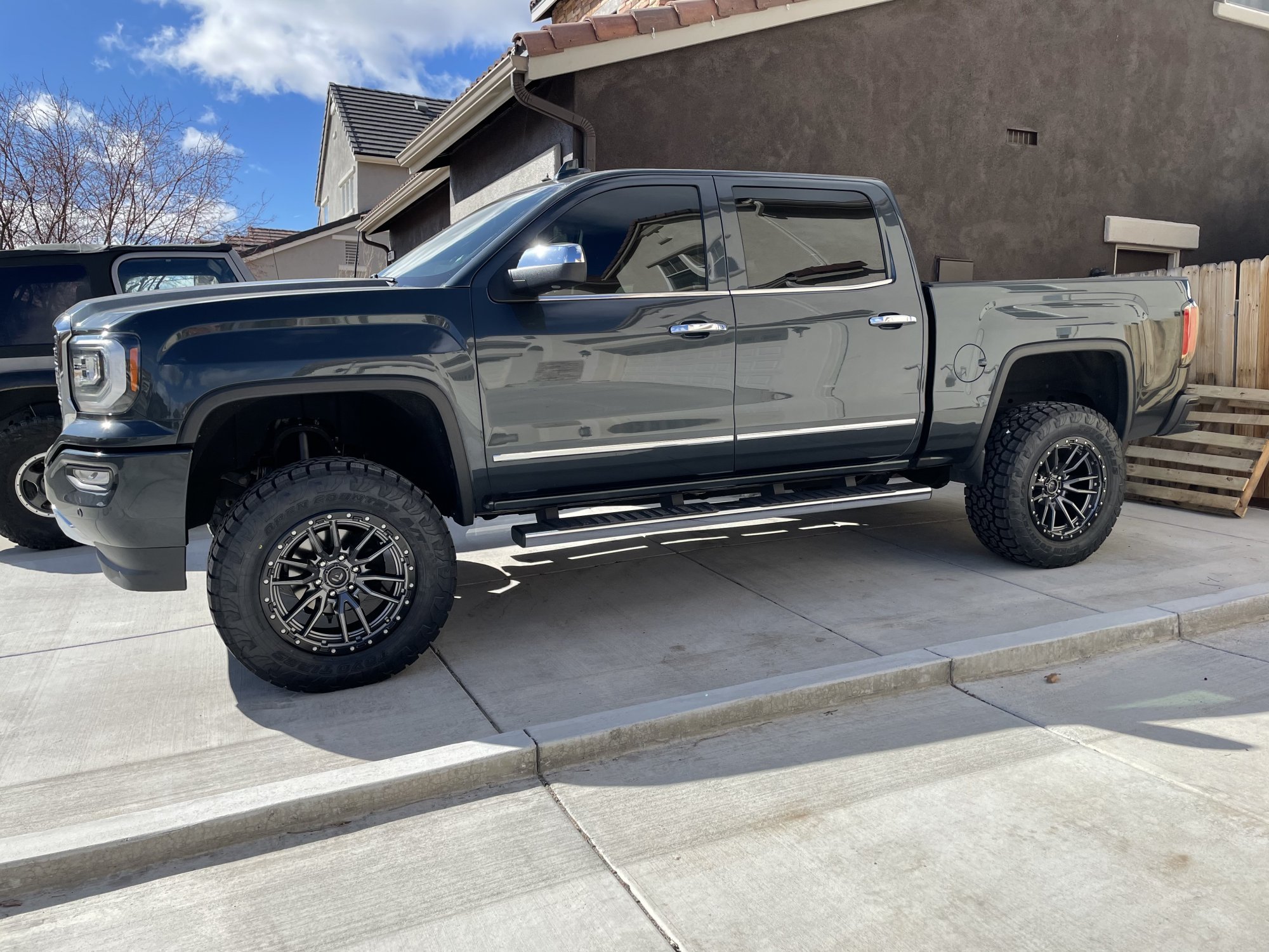

Finally have my lift done & tires installed.  Fabtech 6” Gen II along with 35x12.50R20 Toyo Open Country AT IIIs on 20x10 -18 Fuel Rebel wheels.
Did you have to add a leaf to get the rear even with the front? Looking at getting this lift. Truck looks good.
No, used the lift blocks that are included with the lift kit.  Ad-a-leafs are good, but also tend to stiffen up the ride too.
Add a leaf definitely stiffens up the rear. My lifted Chevy rides firm like a 3/4 ton. It also won't let it sag. I've loaded 25 -40 lb bags of salt pellets and it hardy went down.
Sent from my Pixel 3 using Tapatalk
