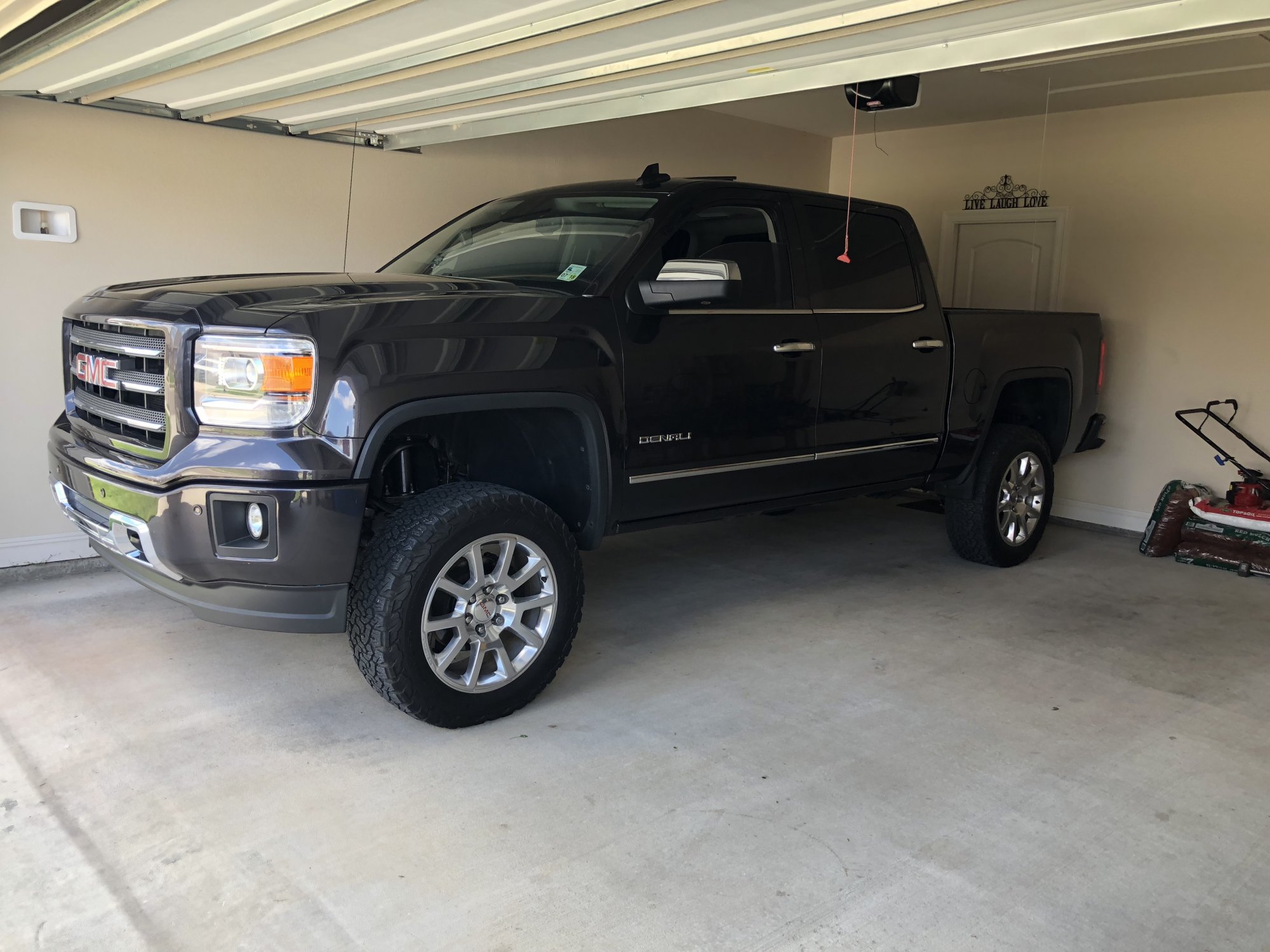

Nice rig! What size tires you running? They look tucked in nice & neat
18x9 +18 offset Method NV and 35x12.50x18.
