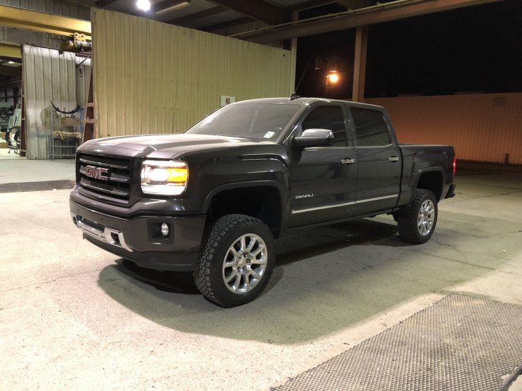

Fabtech Gen 2 6 inch kit is awesome! Track width stays very close to factory. Installed myself at Gerber Collision where I work took me few nights after work but no problems. 2015 Sierra Denali 1500 6.2 4wd. Installed new front coil overs since once was leaking! I will install some 35’s in a few weeks! After alignment all is well.

Unless your dead set on the 7 inch lift I recommend the Fabtech Gen 2 6 inch lift and you wound need to do any trimming! I just finished installing it on my 2015 Denali. Keeps track width nice & neat.

If you don’t mind your front wheels sticking out? Rough Country will widen the front track width 2 inches spacers for the rear to make em match? I didn’t want that look. 6 inch is high enough plus tires are under the fenders where they belong. Each builder has there own taste.

It annoyed the living piss out of me with my RC 6"; the day I picked it up was quite the surprise.
After talking to few folks I ended up ordering 2" BORA Wheel Adapters to fix it. I'm confident going forward with this approach as I was initially scared to crap over wheel spacers. I can't stand the look with my front end out 2 inches and rear tucked under bed.
Unfortunately the installer doesn't care so nothing I can do there. I should have done my research.
