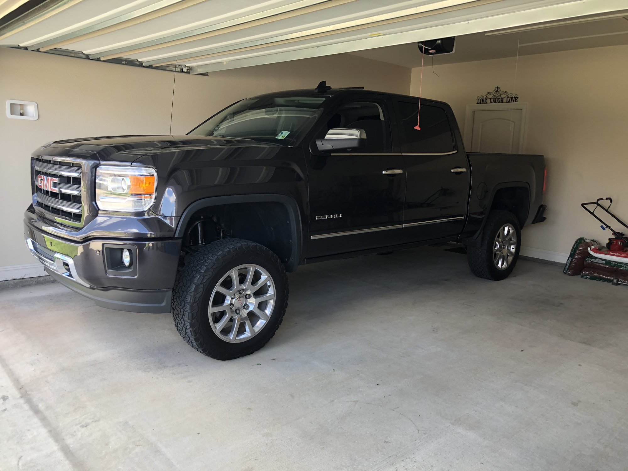

I ran a scanner & it is telling the right rear abs sensor not reading so I bought a new one. Don’t know why it started acting up after the 6 inch lift? I will change it this weekend and hope I can clear the codes & all is well. Why would park assist not be working? Related?
It could have been possible that the cable to the ABS sensors was pulled too tightly when the lift was installed. Accidents happen and I imagine that cable isn't very robust so it could be easy to damage it enough to prevent the right signals from sending. I'm not sure on the park assist, it wouldn't hurt to check an make sure all of the cables going to the parking sensors are secure and free of damage.
Roger that I plan on going over the whole truck this weekend. The rear axle did come down a little too far when I was installing the blocks. Sure would like to have all the systems working properly I’m funny about that! If it’s broke I want it fixed! Other wise the truck rides like a Denali!

Exactly the case! I changed the right rear abs sensor and everything is working fine even the park assist! I did pull the left rear also and cleaned it off they do get grease on them! Nice to ride proud with no warning lights on! Saving for the next piece of the project . 35’s and some amp research side steps!

I did the install myself but the rear differential slipped off the jack while I was lowering it down & must have stretched the cable. The only thing we do not have at Gerber Collision is a trans jack. I had to borrow one to do the front diff. All my mistake. I made few mistakes along the way but lessons learned! I know the kit is intstalled properly! I will retourqe eveything in few more miles. Rides great! Fabtech 6 inch Gen 2 kit is the way for 2014-2018 gm trucks
