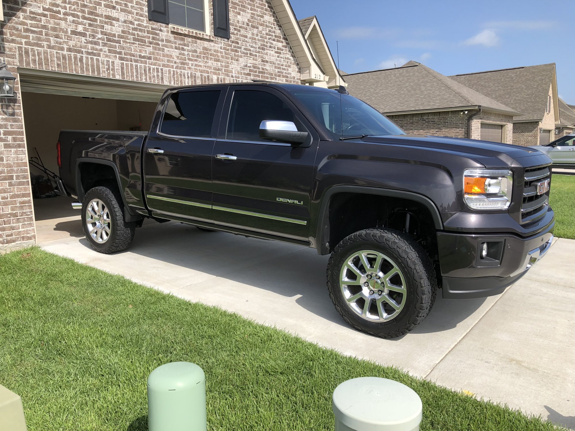

Finally got a nice weekend to clean this bad boy up! Yes I know looks like I skipped leg day with those tires! There will be 35’s soon!
Fabtech Gen 2 kit is a great choice! Did not widen track width! Quality products!
