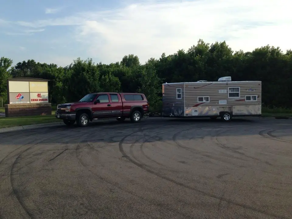

I have a 2004 Silverado Z71 5.3 liter, 3.73 gears, level kit, and rear air bags,and break controller with 17 inch rims. I bought the truck a few months ago and have just purchased an Ice Castle fish house/RV which is rated at 6000 lbs but weighs 5500 lbs. I'm due for new tires and am wondering if anyone has any suggestions. I live in Minnesota and winters can get rough plus I hunt some wicked back roads and the ice on the lakes isn't very forgiving on tires either. I drive 35 mile a day all highway to work round trip also. I would like a tire that is aggressive and am leaning toward the 275/70r17 or 285 BF Goodrich All terrain TA KO's. The day I brought the ice house /rv home (100 miles) it tracked real well, and pulled easy, but my current tires are 265/70/17 Firestone Destinations that are on their death bed. Also while bringing it home I averaged 7.5 mpg, I was using drive with the tow haul on, any suggestions here would be helpful. I suppose this post should be in the tire section but I believe it's really a towing question or both. Thanks
