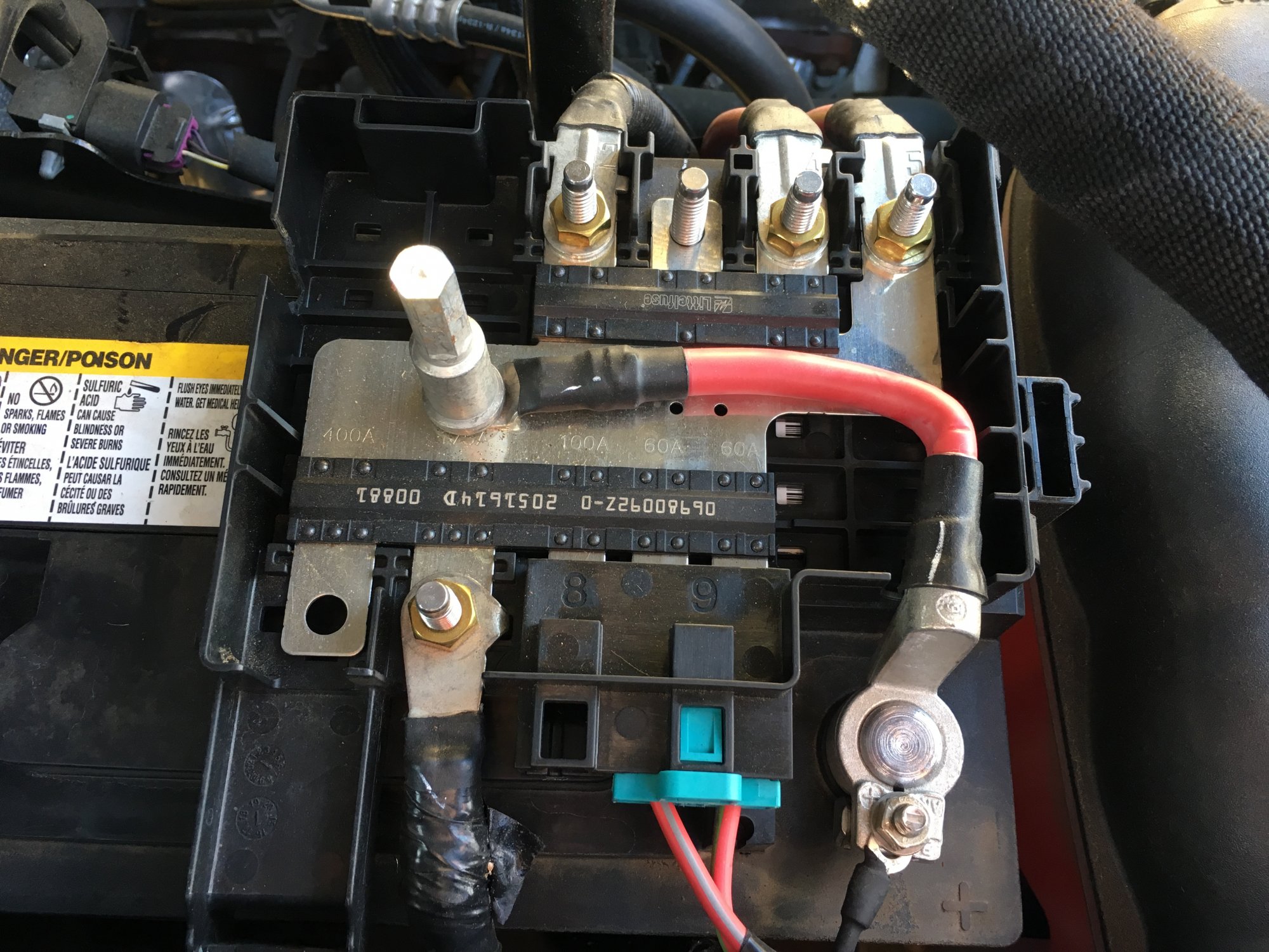

Waymon Posted December 15, 2017 Posted December 15, 2017 I have been unsuccessful in searching where I should hook my power wire up. This is the battery from a 2017 silverado. They have changed it up. Any ideas?
