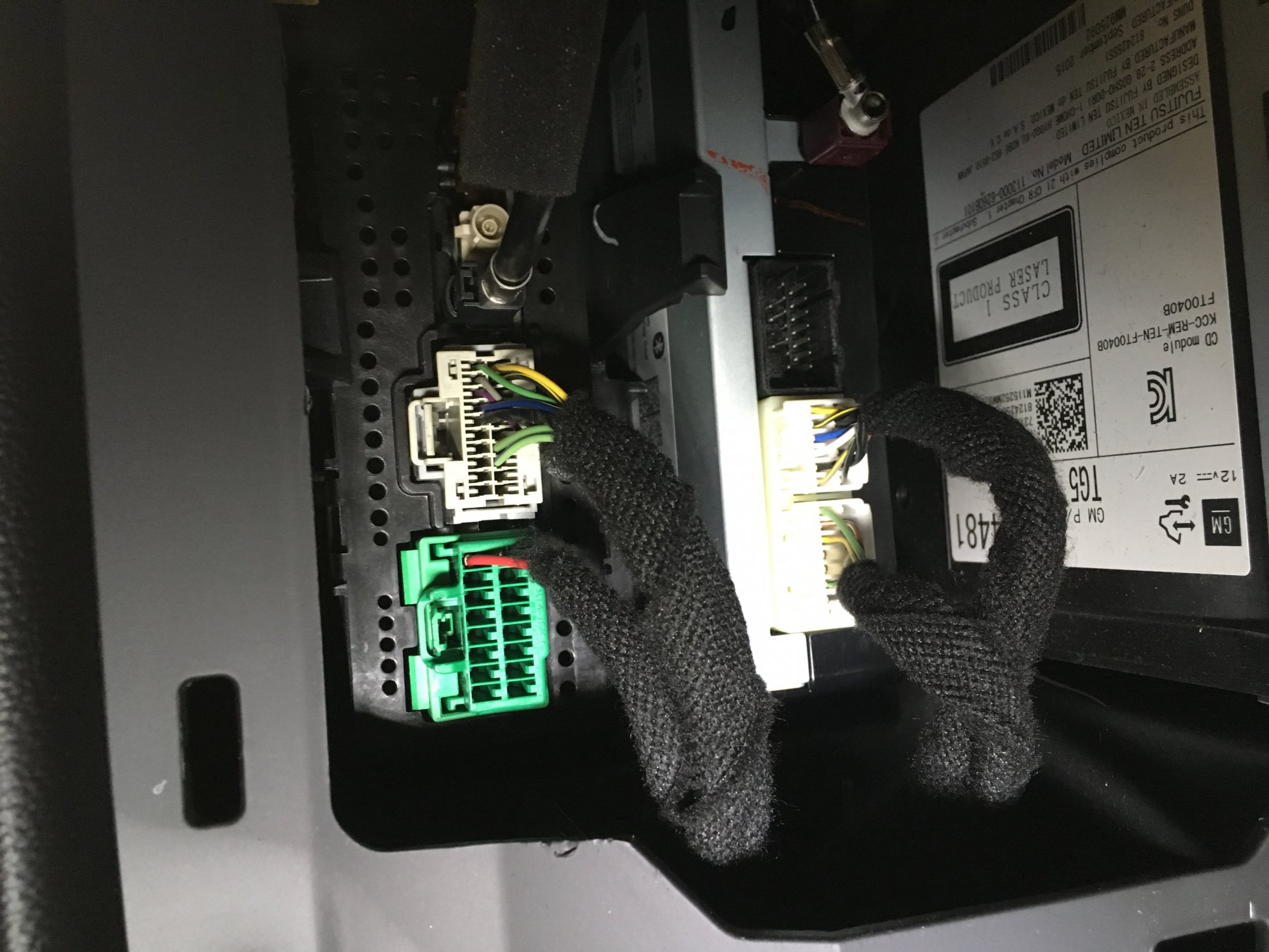

Help. 2015 crew cab Bose w/o sub. Looking to tap the front speakers for my lc2i.  I pulled the screen to get to the wires and I have no wires in the left side plug. (Green plug). Should I be looking elsewhere or just scrap this fun nightmare of a project.
FWIW I answered my own question I think. Seems my wires are coming off of the amp. I was under the impression based upon the YouTube vids and all the post that you had to tap behind the dash.  I’m going to tap off my amp for the front speakers (validated already) to see if it power my loc.
Yep I'm an idiot lol.  Could have saved myself a ton of time taking stuff apart and running wires etc.
all is well. Sub hits and nothing shuts off unexpectedly.
I swear I never read any threads that said to tap at the amp regardless of if you have a sub or not.  Lots of threads that referred to the wire colors etc.
