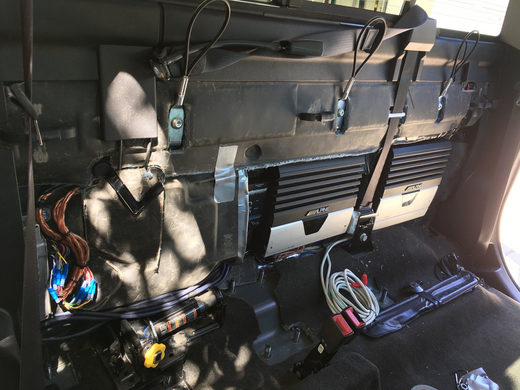

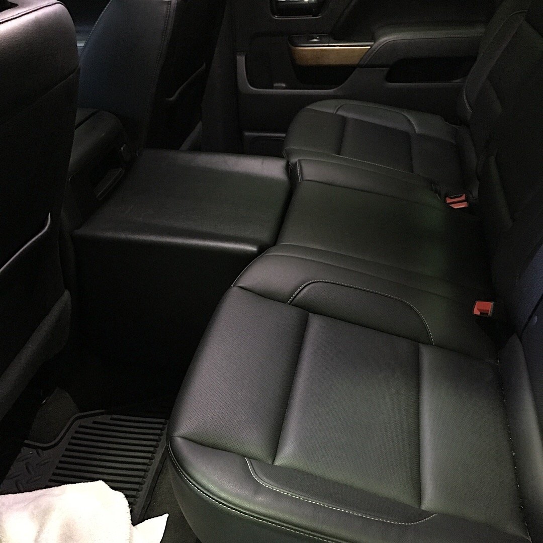

Finally finished my initial audio upgrades. Started by relocating the Bose amp and integrating with an Audio Control LC7i. Dynamated the back wall (the cheap way) and mounted the amps over the back wall insulation that I cut off, modified a bit and kept against the wall.. Alpine MRV-F340 for mids and highs and an MRD-M500 for the sub.

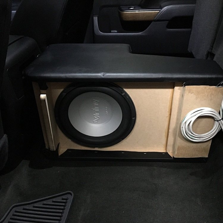

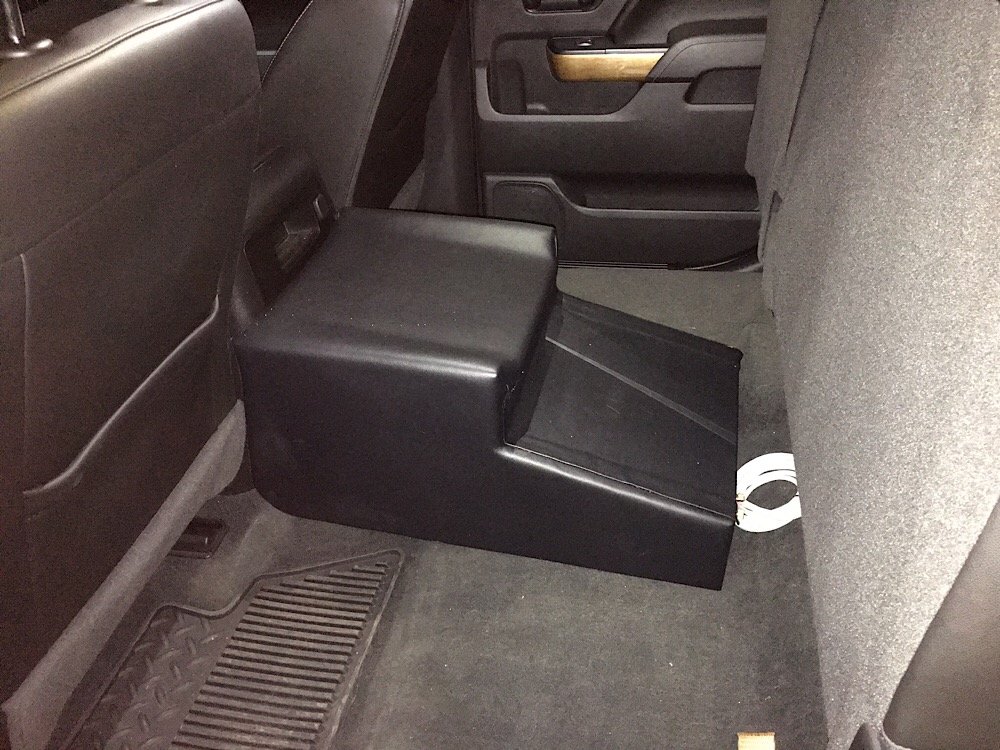

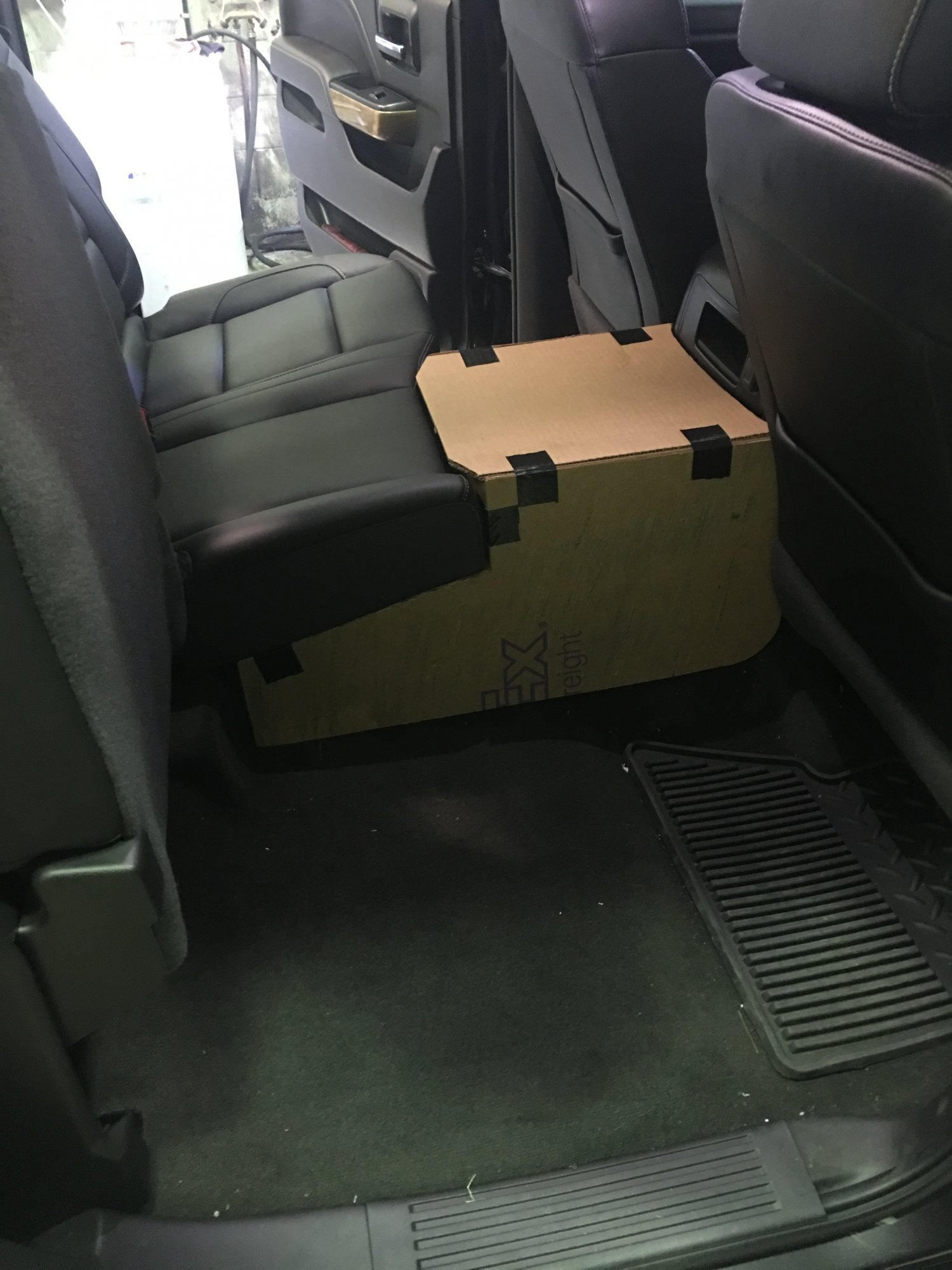

This trick was finding a way to add one of the Infinty DVQ 12s that I already own... So I started mocking up from cardboard an idea to downfire the sub, make it easy to take out if I need and look like it belonged in the truck.

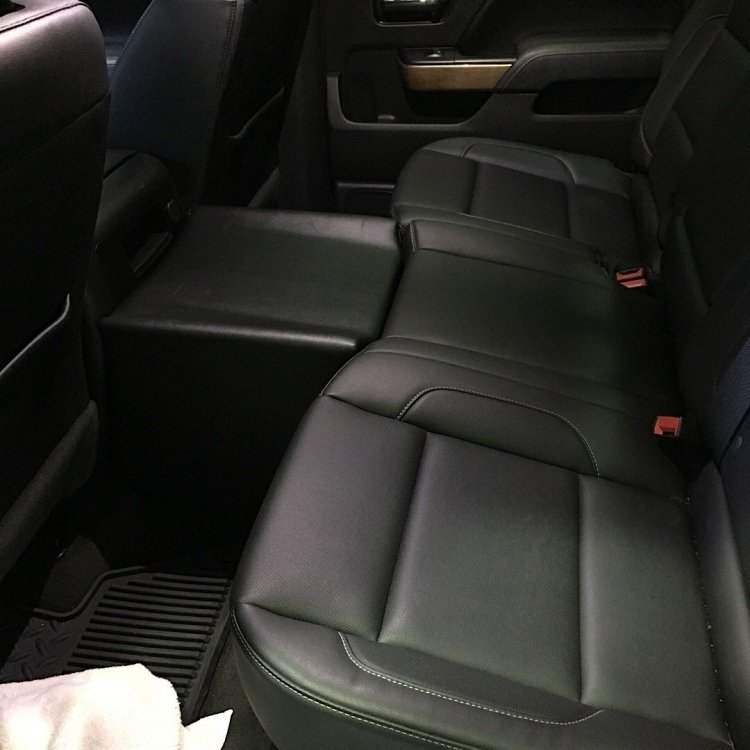

Used some close matched black textured vinyl and some 1/4” foam backing to make it look like the factory leather.
12 inches of glory that looks like it belongs as part of the center console in the rear. Looks good and sounds great!

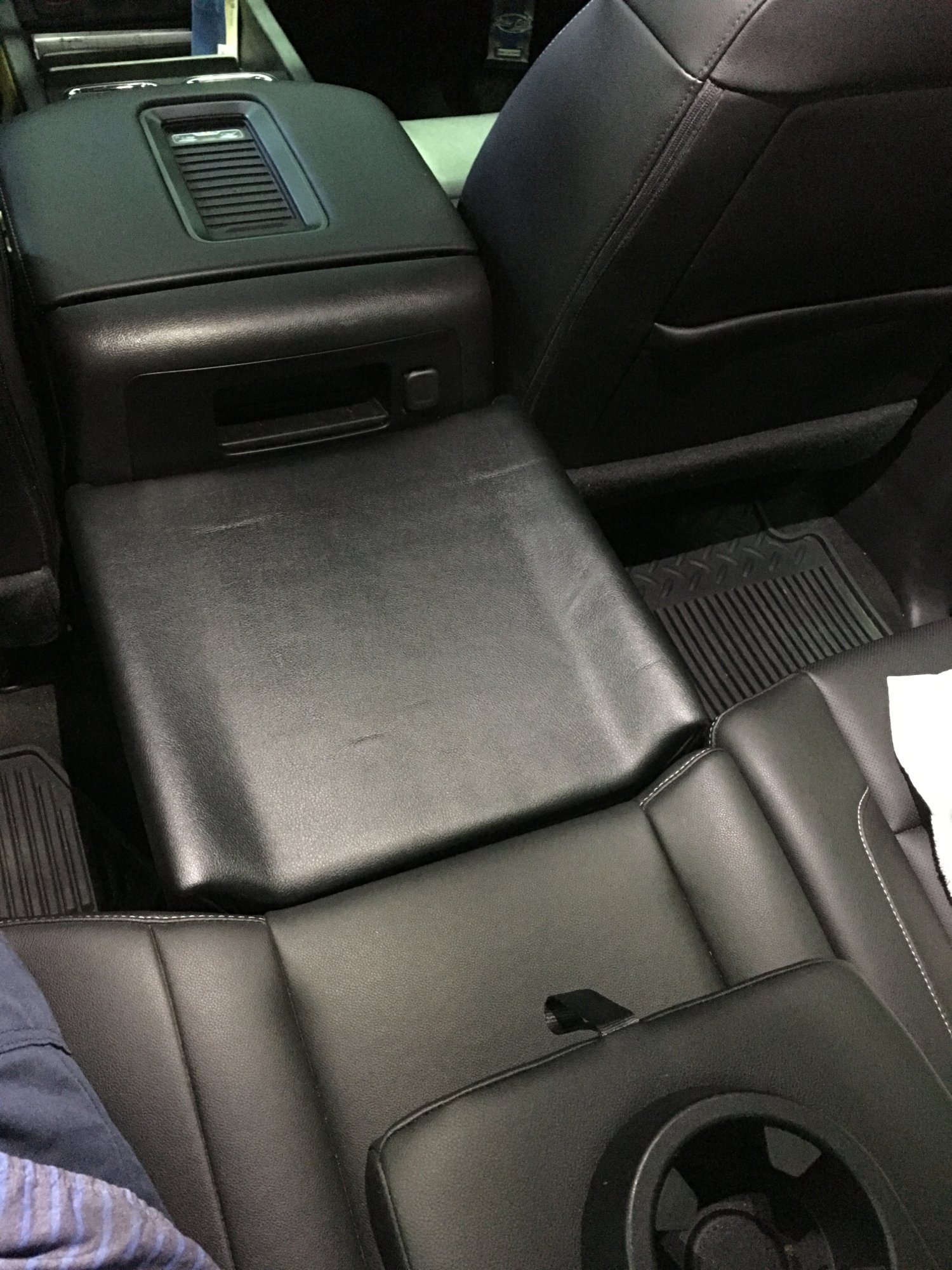

Did a little contouring with some bondo and if you look close, lined it up with the pocket in the back of the console. After cleaning the vinyl a few times it really matches the trucks leather nearly perfectly.
I also lifted the rear seat 3/4” with some black HDPE pucks I fabbed up real fast from some scrap I had laying around at work. I the near future I’m going to upgrade the front and rear speakers. I’m hoping to do some 3-way components up front and 2-way components in the back.

@Ge0rge, HDPE is not wood. Near strong as steel in this application. I understand the opinions on the “in an accident” scenarios, but in having looked at a few of these kits around the internet. I think these pucks are a far better option than what some companies are selling.
@Kyleorsini, I do have a crew cab. It is in a sealed box, I had an idea for a ported box that would extend under the seat toward the drivers, but decided against it because I wanted the tighter bass of a sealed box, and i suppose overall it leaves me with a bit more under seat storage. I have just shy of 1.2 cu.ft. in the box as is.
