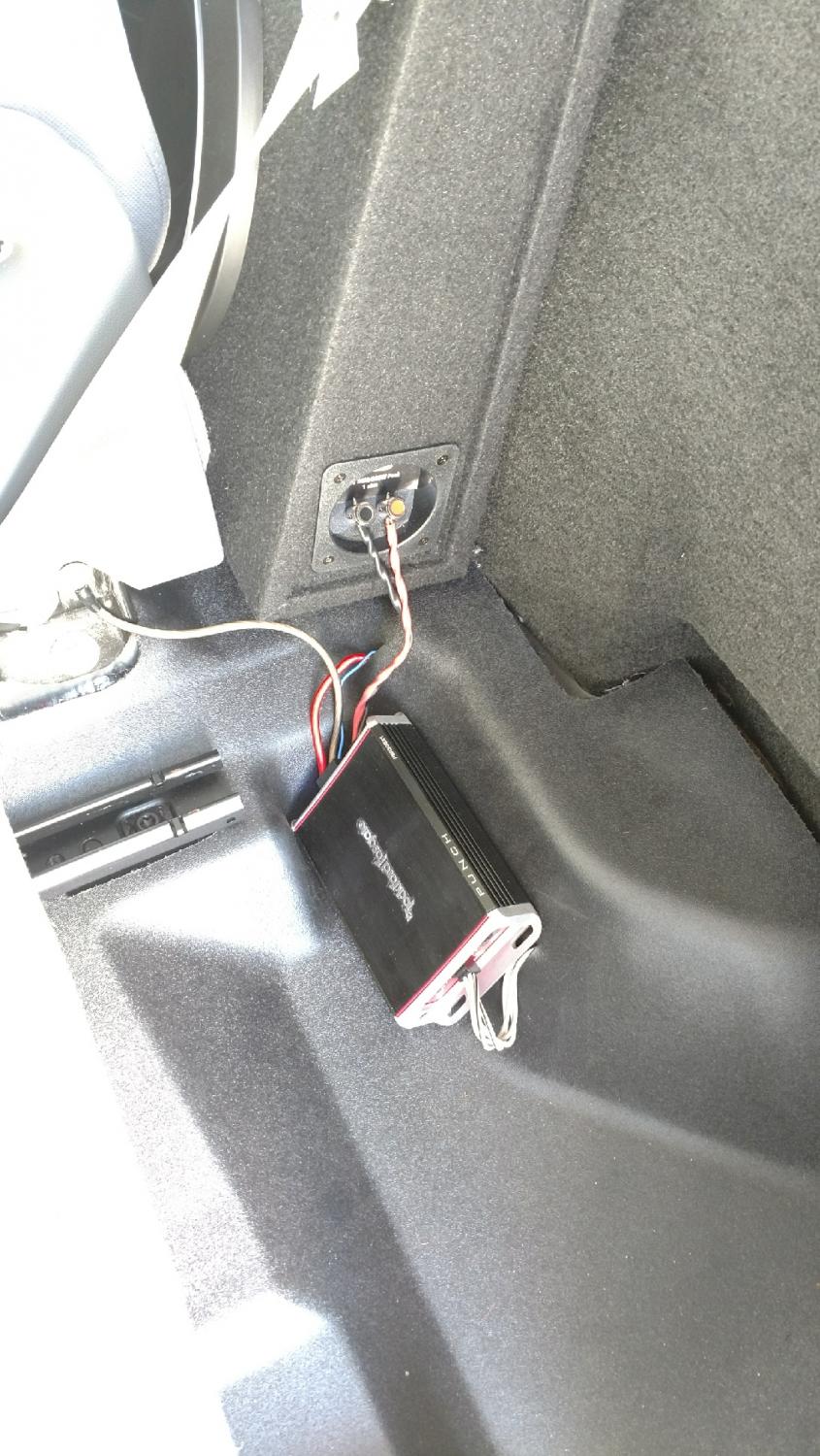

slee3247 Posted February 16, 2017 Posted February 16, 2017 Added a RF P3S-1x10 P3 sub with a RF PBR300x1 amp in a regular cab truck. Sub sits right behind the seats and the amp sits right next to the sub. Tapped the B pillar speakers for the speaker level inputs on the amp. Sounds great, and relatively inexpensive at 300 bucks for the whole deal. If anyone has questions feel free to DM me!
Donolie Posted February 17, 2017 Posted February 17, 2017 Added a RF P3S-1x10 P3 sub with a RF PBR300x1 amp in a regular cab truck. Sub sits right behind the seats and the amp sits right next to the sub. Tapped the B pillar speakers for the speaker level inputs on the amp. Sounds great, and relatively inexpensive at 300 bucks for the whole deal. If anyone has questions feel free to DM me! Did you run the amp to any other speakers, or just the sub? I have a 14 rcsb and no one makes a kit that they say fits. I contacted Kicker already... I installed kicker 40CS6934 6x9 3-way, and still have the 40CS44 4'' 2-way speakers to install. I ask because with my factory radio I cannot hear out of the rear speakers and wasnt sure where to tap in. I thought about tapping in with a LOC behind the radio and running RCA to the rear... can you still fold up the center consul?
