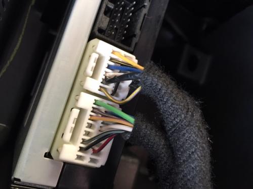

I would like to know if anyone can assist me with the wires on my 2016 Silverado. I have the custom package and 7" radio, no CD player. I am trying to add an amp/sub to my truck. I have read through numerous forums and have only found wiring diagrams that are different from my truck, including non bose systems. I have attached pictures of the wire/plgs behind my radio. I am trying to figure out which wires to splice for the front door speakers to get my signal.
