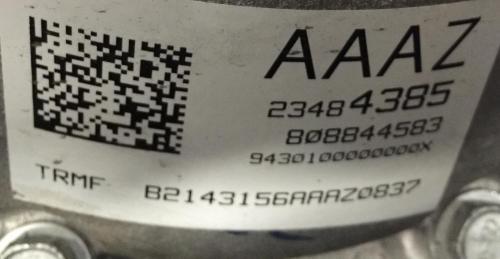

TRUCK IS FIXED!!!
Dealer replaced entire front differential assembly and the truck is as quiet as a mouse!
First picture is of the bad front differential sticker and the second picture is of the new differential. I am not sure what the numbers and letters exactly represent but I thought I might provide them here for reference.

@kylek , yes - see my previous post 65 , heres direct link to it. Its way better then the original though, even tolerable, but yes it did come back , same hum, same speed range etc..
@majikgoats - this first 9 digit number is the part number, the last bottom is the UID (unique ID) , the others not so sure. I broke out the numbers, in case others are searching for any components of this tag, it will lead them here.
original > replacement
AACJ > AAAZ = not sure what that is
23186399 > 23484385 = OEM GM Part number (my original and new replacement 1yr later were both 23186399) appears your replacement was an updated one, possibly just to account for 2015 yr model (although its same diff specs), but could be updated/better quality control etc...
9430100000000M > 9430100000000M = same number, not sure what that is
GMC a2132826aacj7745 > TRMF B2143156aaaz0837 = UID, not sure what the GMC / TRMF means though.
