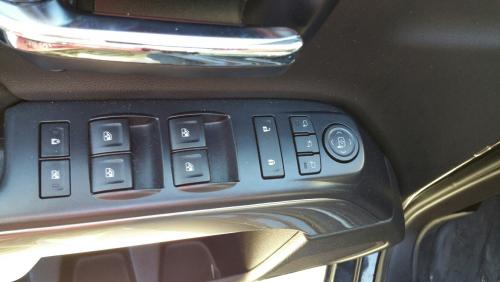

Hi. I'm doing a dl8 to dl3 mirror swap on my 2014 silverado and was wondering if anyone knew the part numbers for the driver master door switches with power folding buttons and the passenger side. I can't find these numbers. Thanks in advance.
Now I called the dealer and they gave me part number for just the power folding mirror switch GM #22754411. He said that's how they sell them. Each switch is separate. It's about $50 to $70 for the switch. Looking at the switch it looks like I can put switch in without bezel, fits in same spot. It just adds a middle button. Now, does anyone know if it will need to be programmed for it to work. Thanks
I'd bet $5.00 it'll take some sort of programming, that's IF it can even be done at all (kind of like Sierra SLT LED headlights being 0% compatible with non all terrain SLE'S). I mean it probably CAN be done but not without some non OEM modifications.
Well I tried to install the DL3 mirror, but the signal and puddle dont work. The weird thing is that the wiring is there for power folding on the connecter but doesnt work casue I dont have the switch. Ims gonna get the switch I mentioned above and try it.. Does anyone know if I could just get a door wire harness to get things to work or the wires would be missing from the cab side also? Anybody have the wiring diagrams for the door and cab side where the wires go into the truck? I see that the cabin side connector the door connects to has more wires going into it then what my door conn. has. So it could be possible the wiring is there. If anyone could help, it would be very appreciated.
