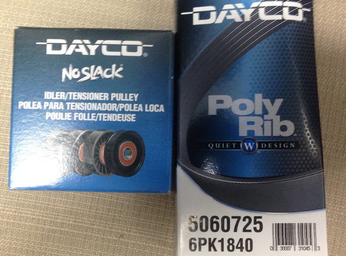

And the extra idler pulley and longer belt. Add a couple large flat washers behind the pulley to space it even with the belt and us the stock alternator bolt with this pulley.
