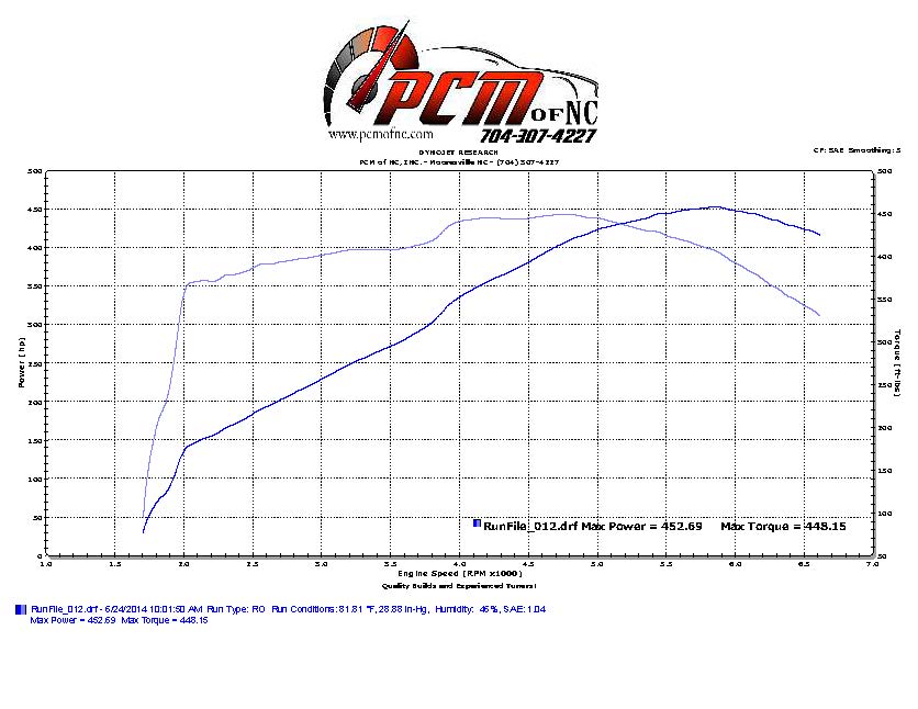

Here's a stock C7 with a dyno tune - before and after graphs.
Followed by one with intake, long tube headers and dyno tune on the same dyno.
I plan to have my tuned at the same place next Tuesday.

also if you look at that graph the only place it made any significant gains in torque was between 4k and 5k rpm with the most significant gain between 4500 and 5k
but if you look where the 2 lines cross this is at 5252 rpm (because of the calculation earlier) the headers made 25 hp and 25 tq (big deal) but it lost 25 ft lbs of tq at 2k rpm.
the only reason the HP is that much higher is because the torque band shifted to the right. the closer you get to 5252 rpm with the peak torque the more HP will be calculated.

I plan to do a before/after dyno as well with the intake being the only change to see exactly what it does. According to the dyno comparisons I've done, it looks like we might lose a tiny bit of torque below 2800 RPM or so but gain everywhere after that (a little in some areas, a lot in others). It's pretty clear to me it's the better manifold for any time you actually have your foot in the throttle more than 1/2 way (including towing), but the stock manifold might have the edge in light throttle cruising (admittedly, where 90% of owners spend 90% of their time). It'll be interesting....

As for the gains, my engine shifts at 6200 so power above 5200 does make a big difference if you're trying to accelerate quickly. And it should be a pretty large gain on the top end. And my prediction shows while the torque peaks will be very close in value, the stingray manifold will have a lot more area under the torque curve, starting at just 3000 RPM--which means it may be a very beneficial mod for towing as well.
And FYI: Chassis dynos don't measure torque. They calculate torque from the HP they measure. Disconnect the RPM pickup and a chassis dyno can still measure your HP but it has no idea how much torque you're making.

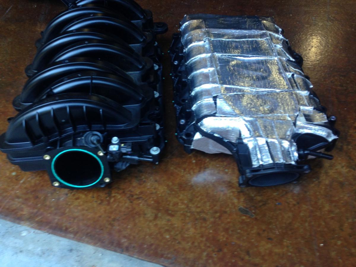

I got the C7 intake manifold installed.
I'll get some pics up soon.

Here's the two intakes side by side. L86 on left LT1 on right. I added the silver radiant heat insulation top and bottom.
And the final installed pictures. I painted the top cover to match the truck.
