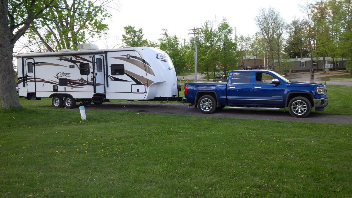

hydrogencyanide, don't mistake me for weight police at all because I have a 37 footer that I towed with a 1500 and had to fight them off all the time...but is your WD set up properly? look a little saggy

I'm actually going to move the brackets up another notch. I have an equalizer hitch and need get it dialed in correctly. It is also on a slope in that photo.

What are the specs on your trailer? truck? hows she pull?
