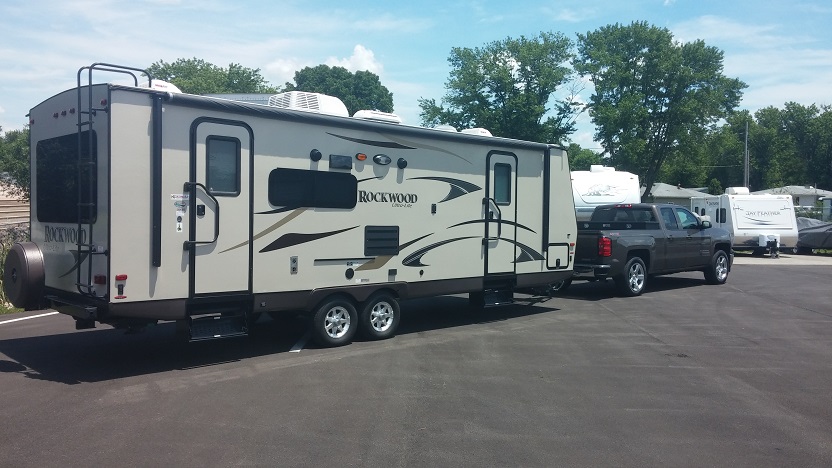

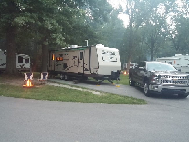

First pic was before I had he WDH dialed in. This truck pulls SO MUCH better than my 2011 CC Z71
Nice setup!
Initial loading with 1/2 fender height as target resulted in my RAW hitting 4060 and my FAW hit 3400. This would literally make people sick in the truck as the already underdamped front end was literally moving like a pogo stick.

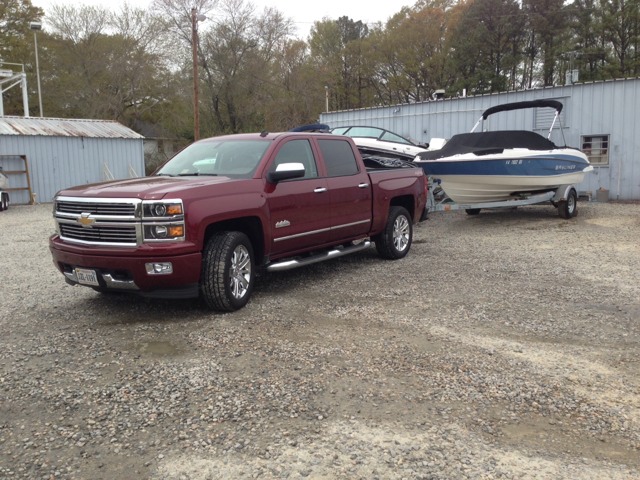

All I've towed is a 21ft bow rider. I have the 5.3. The truck does very well. A little slower accelerating and stopping. Gas mileage drops a bit too, but nothing unexpected. I'm happy with it.
