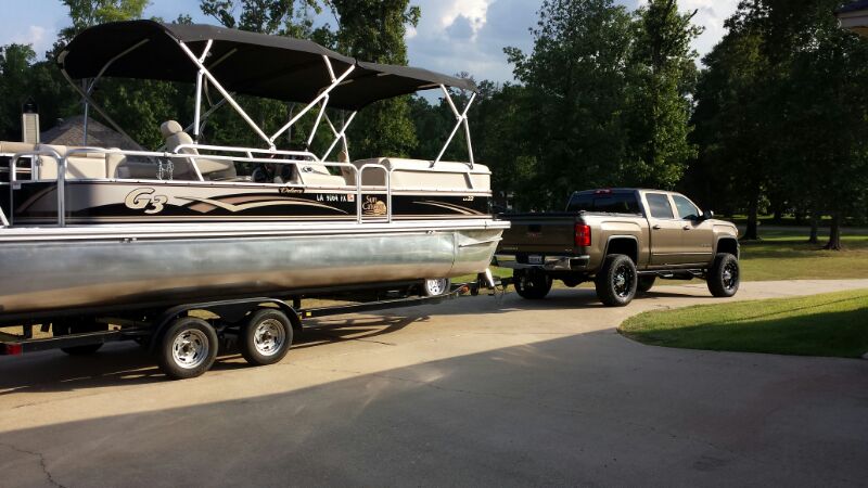

22' pontoon on a regular basis. Around 5k loaded heading to the lake. No issues with 4.56 gears, 35's and 6" lift.
What size drop hitch are you using? I have a 5" block in the rear and Mcgaughys' 8" lift up front.. on 35's
It is an 8" adjustable b&w tow and stow. I have a 5" block as well as an add a leaf so I have a total of right at 5" of lift over stock. I run it at about 6" with this boat and my fishing boat. With my little utility trailer it needs to be set at 8" to get the trailer level.

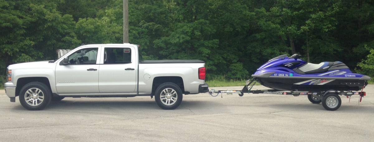

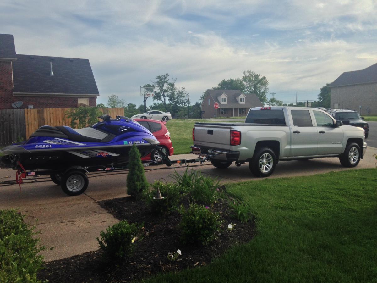

My 2013 rxpx 260hp supercharged. Making 21lbs of boost right now. Only has a top speed of 83mph right now. The t3 hull is amazing and turns on a dime! Race ameture right now. 0-60 just under 5 seconds.
Took this this morning, waiting on 2 o'clock to head to the lake.
1577848B-AD09-4148-9ECF-38A2192EBDD8_zps
What else do you do "right now?"
I kid, I kid.
