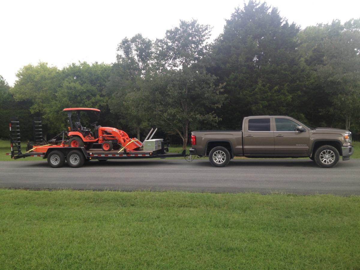

From this weekend heading up to my mother in law's childhood home to do a bit of cleaning up. Couple of kids kicked in the tack room door in the barn and messed around. We figured if we did a bit of mowing and cleanup it might discourage folks from trespassing.
Anyways, trailer goes about 2,200 and the tractor is aroound 3,600 so with gear in the box the whole kit is likely in the 6K neighborhood. Truck and trailer combo worked well. The only thing I had to do was adjust the hitch height up a touch from the position it is in the picture.
I noticed a bit of bounce towing the trailer empty but absolutely none loaded. Trailer itself is 20' and rated to 10K so I could pull up to the 9,600 lbs the truck is rated for. However, in a reality, I doubt I would ever really want to do that, or if I did it would be a on a very infrequent basis. I love my truck and its capabilities but I think I would like to have a bit of "reserve" between the max tow rating and the weight of what I am trying to haul. *Just my personal opinion YMMV*
