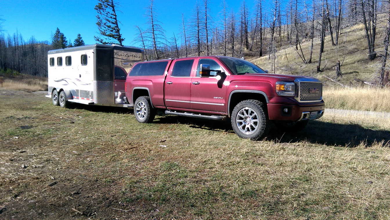

New three horse slant. Very nice. Around 9,000 lbs with three horses and a bunch of gear, etc. Pics from recent elk hunt:

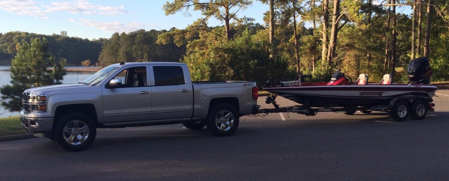

This is what I am towing. After towing that for the summer, I decided to add bags just to help out. They are now installed but I won't get to try them out until next spring.
New three horse slant. Very nice. Around 9,000 lbs with three horses and a bunch of gear, etc. Pics from recent elk hunt:is your truck a max tow with 3.73 gear?does it seem to pull the 9000 pounds fairly easy? I ask because mine is a 6.2 with 3.42 gear and I will be towing my toy hauler which will be around 8000 pounds when loaded with motorcycles but not until next year,I did hook my trailer up for a test tow when my truck had the required 500 break in miles on it and it seemed to do a pretty darn good job but I only went around 15 miles and the trailer was empty of motorcycles ,I am a little concerned because I have read a few posts lately of people complaining about there trucks pulling prowess with a lot less weight but these where 5.3's so may make somewhat of a difference.
Mine isn't max tow, it has 3.42's and also has 34" tires so some gears will certainly make it better--I'm planning to put 4.10's in when I get a chance. But realistically it'll be more of a nicety than a necessity. It pulled the trailer very easily--I was accelerating up steep hills at 65 MPH without much effort. This is at 5000+ ft elevation where it has less power as well. I do have longtubes, CAI, etc, which certainly helps some.
Peoples' experiences with the 5.3's aren't really that relevant to the 6.2. The 6.2 has as much torque at 2000 RPM as the 5.3 does at 4000 RPM which makes for a much different towing experience.

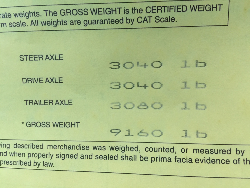

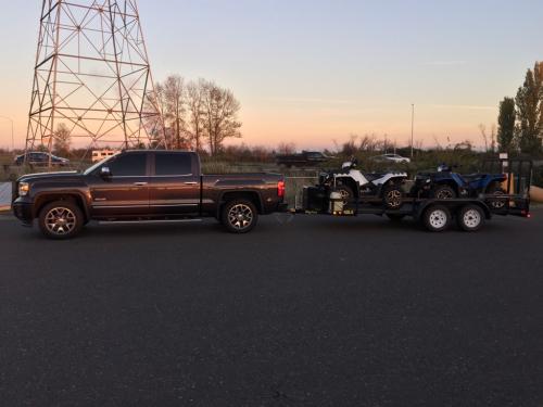

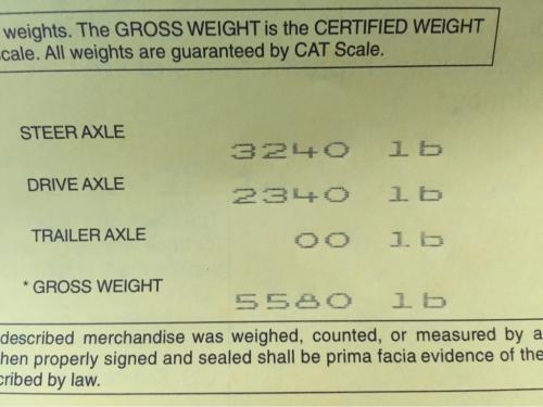

Finally passed the 1k mark last week and took our trailer out for a spin to see how well the 6.2L did at towing. While we were out, I did a full fuel load in the truck, quads, and spare cans then weighted in. Here's the results. Overall I was really impressed with how well our Sierra pulled vs our old tow vehicle. Can't wait to take it on a long trip now! post-135887-141585943345_thumb.jpgpost-135887-141585944551_thumb.jpgpost-135887-141585945956_thumb.jpg

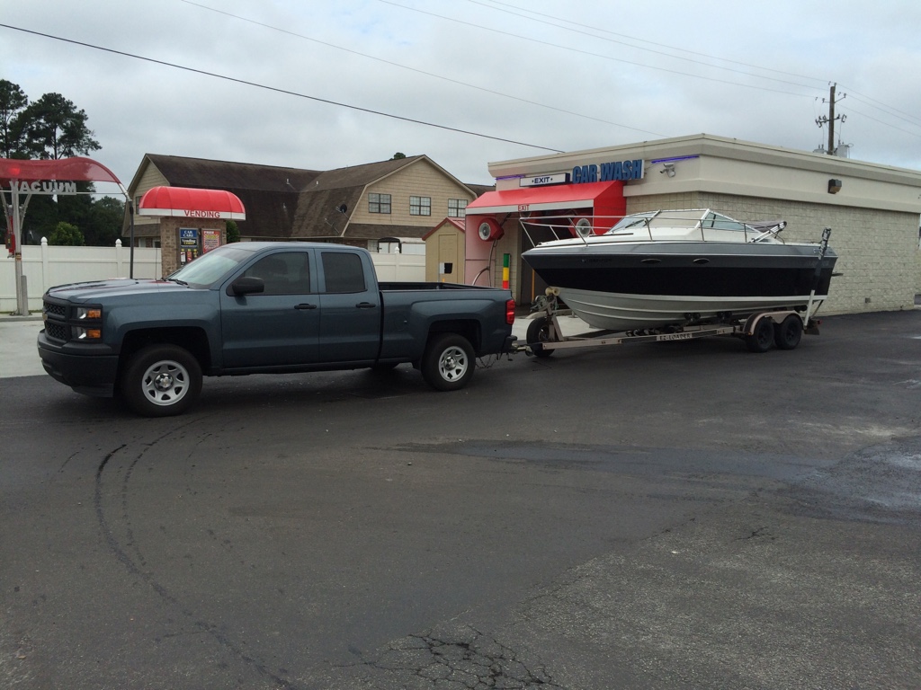

My 2012 5.3 wouldn't tow This boat up a grade with out putting me in the right or emergency lane. Love my 6.2 it tows the boat like a champ
