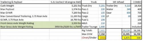

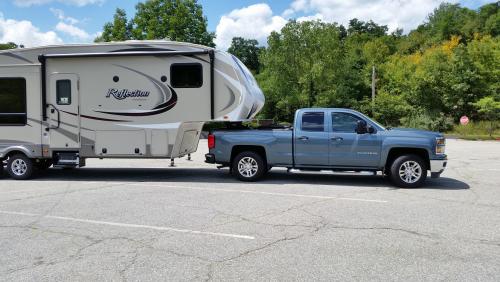

I am indeed relying on the “Max” part of the Max Trailering Package. My rig is a 2014 Silverado 5.3L 4x4 3.73 Max Tow and a 33 foot Grand Design 303RLS 5th wheel. I am curious to hear what some of you think of the chart below. I installed a set of Timbrens to level out the rear.
I only tow the 5th wheel 7 or 8 times a year. While towing, I get about 8 miles per gallon running aggressive and fast. Driving the speed limits and taking it easy I get 9 to 10 MPG. What’s really nice is I get 17 MPG around town and 22 MPG on the highway without the trailer. While the 2500 would have definitely been an overall better fit and likely drive a lot better at full-load, 98% of the time I drive unloaded. So the 5.3L 1500 w/Max Trailer seemed the right choice for now.
My 1500 is fine. But it can get a bouncy at times. I am sure the 2500 would not bounce as much. Another thing; the 2500 would has a larger gas tank and more payload headroom to add things like a spare gas tank, tool boxes, etc in the bed. But my wife and I figure that once we retire and travel more with the 5th wheel, we will buy an HD truck.
Please note: The standard rear gross axle rating is 3,950lbs. But the chart shows we get another 150lbs (4,100lbs) with the 3.73 rear-end. So my computations for Max Gross Vehicle Weight with the 3.73 is a total of 7,350. Though I am 332 lbs over max payload, I am 554 lbs under max combined weight.
You also need to meet the maximum trailer rating.
Max trailer tow rating for 5th wheel is 11,200 for a 2014 5.3L 4wd 3.73 (if you have a double cab, less for a reg cab)
Your trailer is 4200 lbs over the rating.
http://www.gmfleetorderguide.com/NASApp/domestic/proddesc.jsp?year=2014&addOptions=true&regionID=1&divisionID=1&vehicleID=14682&section=trailer_specs&pagenum=2&butID=8

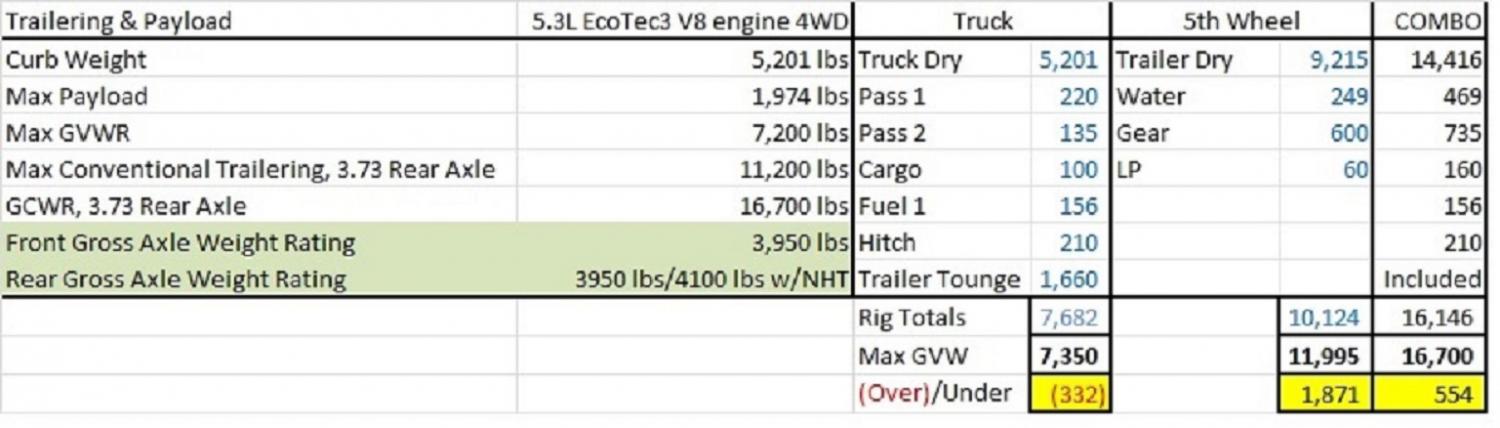

I am indeed relying on the Max part of the Max Trailering Package. My rig is a 2014 Silverado 5.3L 4x4 3.73 Max Tow and a 33 foot Grand Design 303RLS 5th wheel. I am curious to hear what some of you think of the chart below. I installed a set of Timbrens to level out the rear.
I only tow the 5th wheel 7 or 8 times a year. While towing, I get about 8 miles per gallon running aggressive and fast. Driving the speed limits and taking it easy I get 9 to 10 MPG. Whats really nice is I get 17 MPG around town and 22 MPG on the highway without the trailer. While the 2500 would have definitely been an overall better fit and likely drive a lot better at full-load, 98% of the time I drive unloaded. So the 5.3L 1500 w/Max Trailer seemed the right choice for now.
Ho Lee fuk. You need to hit a scale and check your numbers. You're basing this all on the brochure number which I guarantee are wrong. My trailer said dry weight of 5200ish...I hit a sCale on my way home and found it was about 500 over the brochure weight. Truck as well will differ from advertised
Your hitch weight you wrote was the dry based on an average. 5th wheels generally have a hitch weight of 20% of the calculated weigh . If you figure your trailer weighs 10124 then your hitch I bet is closer to 2,000 lbs not 1600 which puts you way over.
Granted, you may feel like it tows well, and I'm sure it handles it, that's a lot of trailer and gvw for a 1500.
