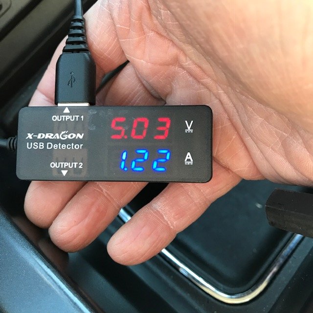

The reviews say you can change an iPad with the USB ports which take 2 amps, but my Note 3 phone also takes 2 amp charger. Yet when I charge with these ports I only get .5 amps. I am using an adapter from my old truck in the center console now to charge my phone. Anyone else getting a good change from the front 3 ports. LTZ model, so may not be the same on all.

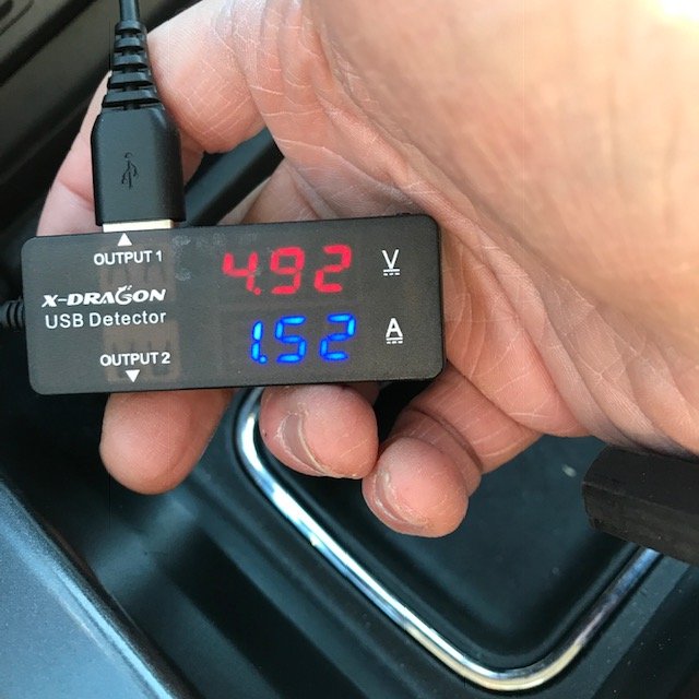

On my 2016, I see up to 1.5A on the USB port charging iphone.
