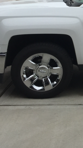

What tires do you plan to run?
Should they fit, I was planning on running the stock tires on the 20x9 wheels it came with until the tread runs out
Thanks. Fits in the garage... Just barely. Yeah, it was taller than I was expecting... 43.75 to the fender...
That's crazy. I looked at a truck the other day that supposed to have a 4" lift and it was 40.5 and 41.5.
stock fender height on my all terrain was 36 inches two inch level and tires put me at 39 in the front. So a four inch lift would bring it to around 40 inches on stock tires.
