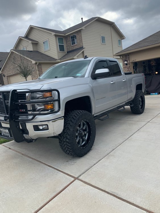

15 hours ago, Aveman411 said:
7in Rough Country with loaded struts. 35 12.50 20 Nitto Trail Grapplers on 20x9 (0 offset) Moto Metal 970s in Black/Gunmetal. 1.5in rear spacers.  No trimming but plastic air damn was removed.  Slight rub in reverse at full clock.80394F1A-08D2-4F91-AC89-E2EA7E6D62BB.thumb.jpeg.4adb9bb4193bb3eff6062baa6b418280.jpeg
Why the 1.5" spacers in the rear?
The front stick out more, most lifts and level kits do that the rear usually more in bout a 1”

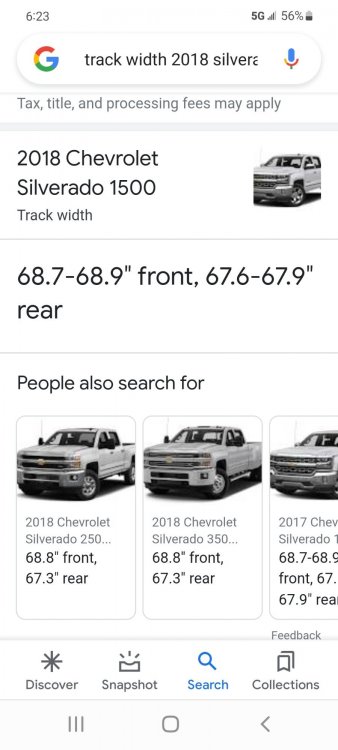

Actually stock the front is around an inch wider already. Or 1/2" on each side.
I measured mine before and after the lift .
Before , the front was 7/8" wider. After lift it was 2 1/2" wider. I added 1" spacers on the rear. Now the front is only 1/2" wider or 1/4" on each side. Close enough.
They look the same now. Before the spacers it was pretty noticeable.
Frankie has the same lift and did the same thing.
I think the rough country lift set the front wheel even farther out thats why 1.5" spacers
